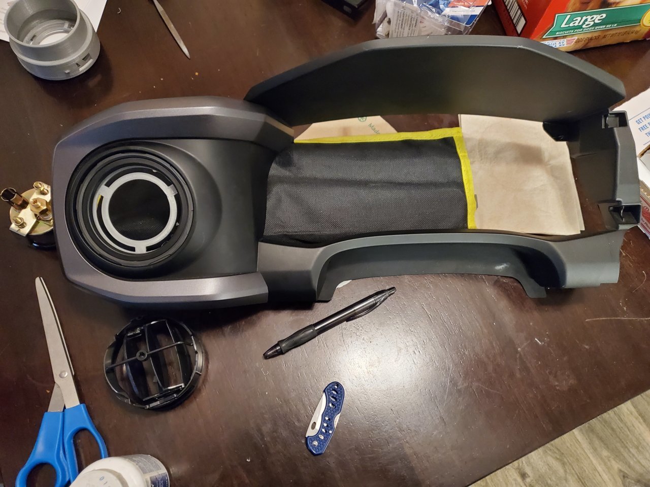

    Did we hear anything about catted downpipes?
  16. May 27, 2020 at 6:49 PM
    #7636
    Bigetaco22
    Bigetaco22 Well-Known Member
    Sep 30, 2018
    #267885
    504
    Kenny
    2016 DCSB TRD OR
    Bilstein 6112/5160s. OME leaf springs. 285/75/16. RC tonneau cover. Supernova v3 led lows, highs, and fog lights. Kicker speaker upgrade.
    Vent mount is coming along. Changed design and will fit in both driver's side vents now.
  17. May 27, 2020 at 7:19 PM
    #7637
    TWTaco
    TWTaco Well-Known Member
    Dec 19, 2015
    #172601
    5,978
    Dave
    Awesome good job! I like it on the left it keeps the right side cleaner more OEM if that makes sense.
