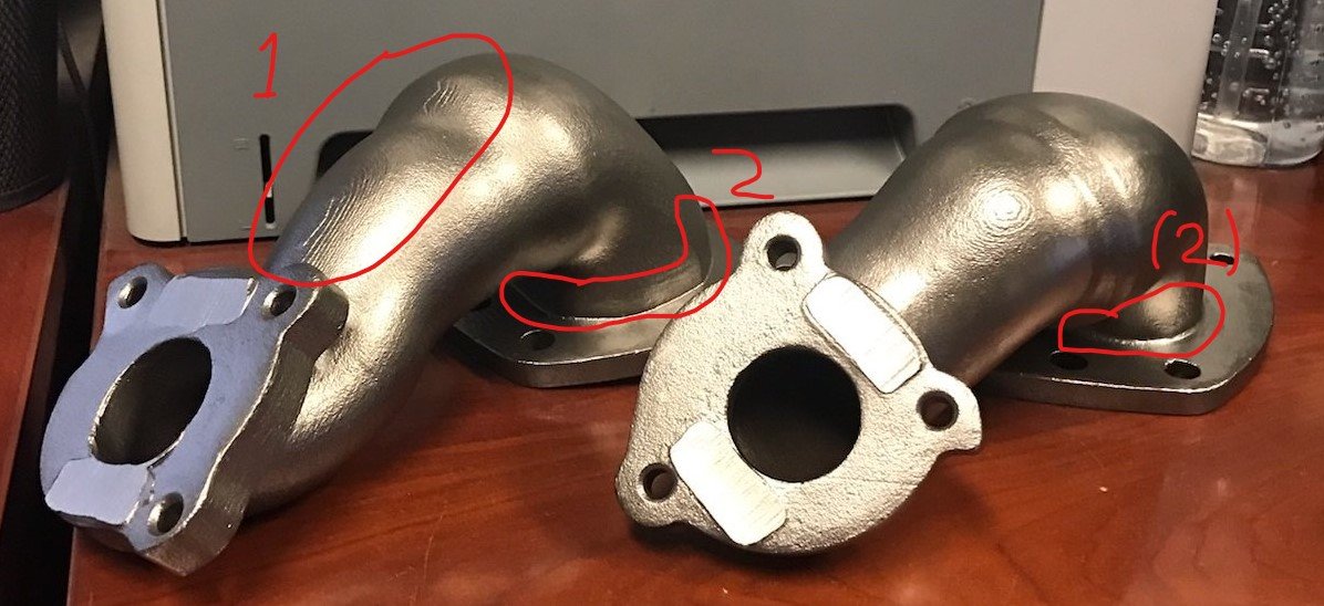

    Thanks, I have no experience with casting.
    Which area specifically?
    The pics on here are our prototypes (before finishing / machining).

    maytime
    maytime Member
    Feb 19, 2017
    #210987
    20
    Everett, WA
    If these are just the prototypes, then they probably already fixed the surface finish for production, indicated in area 1 of my picture. You can see how the wax pattern was "layered" like a topo map, which is indicative of the FDM additive mfg process. These layers will also be inside the pipe. When you get your first production run, check for these striations, and you will know if they are continuing to FDM the patterns, or they either made the wax pattern dies or moved to SLA.
    What may not have been fixed is the tight fillet rad, shown in area 2. I wouldn't expect to finish machine this side of the flange all the way to the pipe so it might still be there.
    xxTacocaTxx likes this.

    OVTune
    OVTune [OP] Well-Known Member
    Mar 27, 2017
    #214557
    8,112
    OVTune
    We selected a company here in the USA with very high ratings for casting ability and quality. I could only assume they do it properly. These are investment cast. (but the imagine is prototypes).
    The area you selected is oval with increased thickness.
    They are also put through heat treating process, X Rays, etc.

    #7648
    maytime
    maytime Member
    Feb 19, 2017
    #210987
    20
    Everett, WA
    Fatigue crack propagation is agnostic of wall thickness. All it takes is one crack starter (sharp corner, nick/tool mark, material inclusion, etc) and the crack will propagate thru no matter how thick the material is.
    If they are a reputable shop, then I'm sure it will end up being a high quality product.
    o313 likes this.
