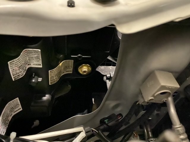

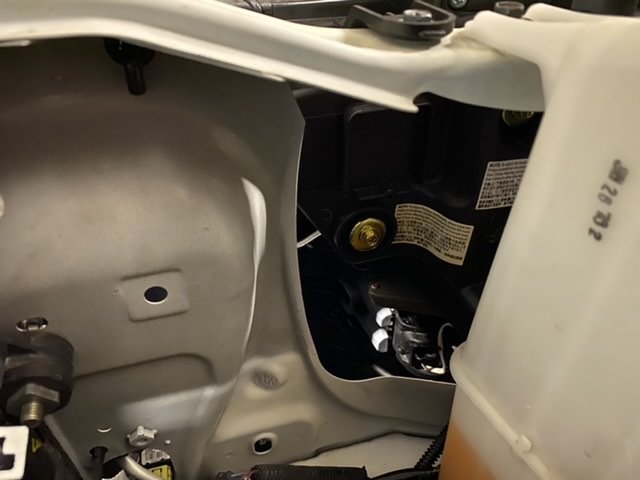

    Just a FYI, if you have the OEM 2020 LED headlights I don't think a 3" intercooler piping will squeeze in next to it. The LED headlight buckets are a little bit bulkier in the back compared to the halogen models.

    I think it'll be the same story for the Morimoto XB LEDs. I was looking at mine the other day and it looks like there isn't as much room.

    I posted a bit back that the hard pipe in this are is changed to 2.5 inch. 3 inch is tight fit even onstock

    It looks like it will be a tight fit. I may have some 3" intake piping laying around, I'll check. 2-1/2 should clear just fine.

    Awesome, good to know. 2.5 should work.
