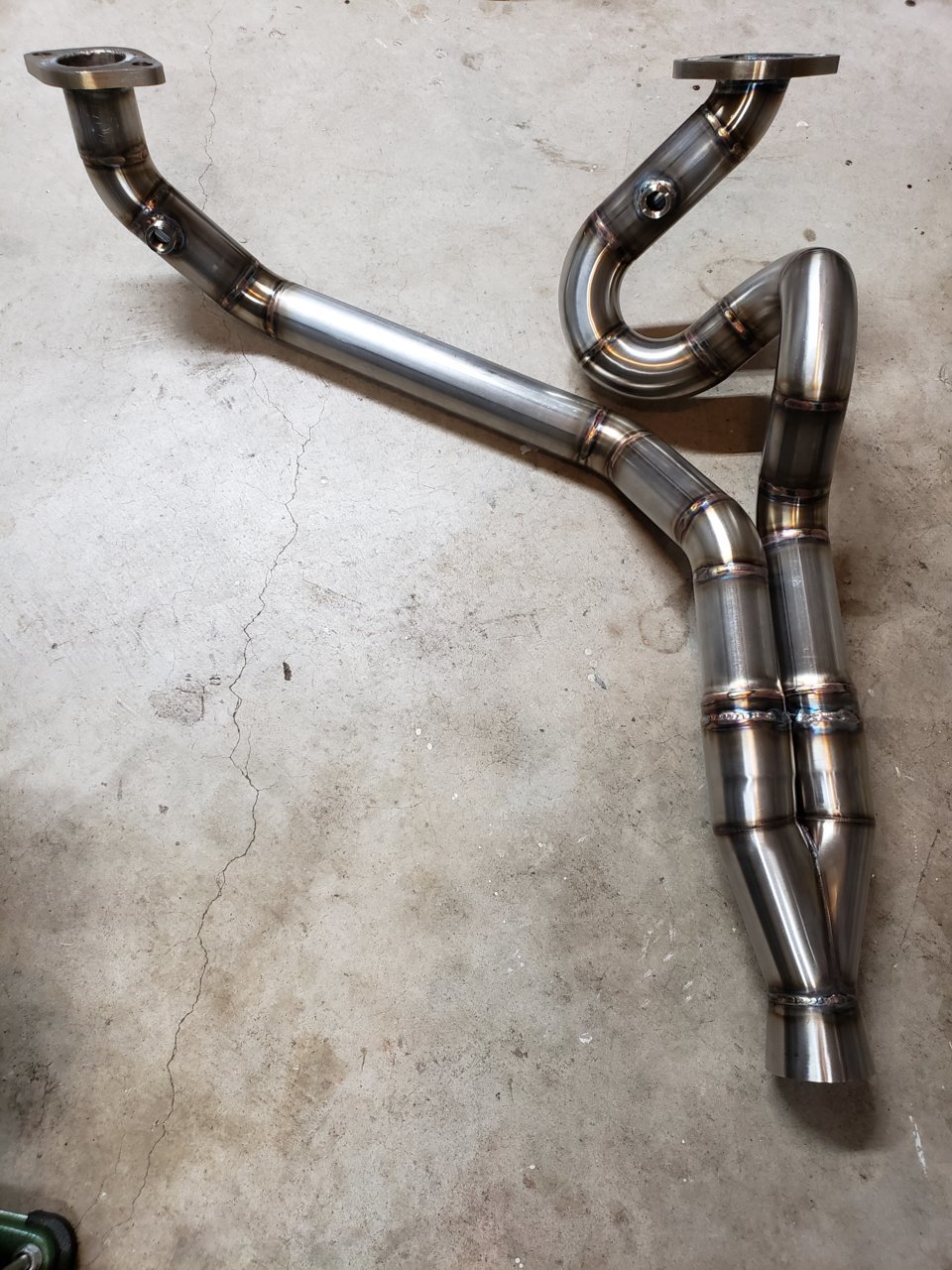

    On a another note, I went with a PLX devices SM-AFR/SM-PRO and perfect tuning universal gauge. A bit overkill, but so is this TT kit! I’ll be welding my own full catback, about to order all 304 piping for it. Something similar to Roostfactor‘s y-pipe, just look at it...

    Woah that’s beautiful!

    From what I’ve gathered, he designed the equal length y pipe to maximize scavenging (lots of specific engine data from the 4.0’s went into account); which is critical for NA and Supercharged 4.0’s. Not as big of a deal on turbo exhaust setups.
    I’m after a quieter/sleeper system. 2-1/2” y-pipe with resonators where the 2nd cats are, merged to 3” into an oval muffler (something like Walker SS quiet flow) then 4” tip, single. Turbo spool noise, deeper tone and a bit louder than stock at WOT is what I’m after.

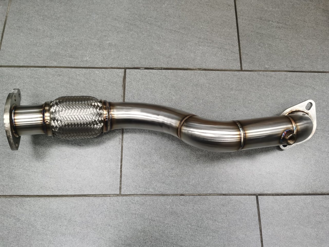

    Cat less downpipes

    Update >
    Catted dumps are still processing fabrication. Cat less will come first *if* anyone wants cat less.
    Everything else is pretty much ready to go. We are waiting on some things to get here (like some more powermax turbos)
    We should be able to start getting some on road videos and such after Fathers Day. We are *slighty* behind our *estimated* shipping date, but not off by much.
    So, to know who gets what first.
    > Base kits, cat less without intercooler setup are first to ship
    > PowerMax, Cat less witohut intercooler are second to ship
    > catted version + 1 week estimate. (only reason is waiting on different version flex pipe, as the catted is cat + flex)
    Downpipes are same quality, fully back purge TIG weld like our Dump Tubes.

    Work of art! Is that 2-1/2” or 2-1/4” pipe?

    2 1/4

    Out of curiosity, why are these getting flex pipes? The engine is longitudinally mounted so normally there wouldn't be any front-to-back torsion. Does it have to do with how they are mounted to the turbos?

    We included the flex section because there is noticeably more engine torsion side to side in boost / going into boost where torque ramps up 100+ ft lbs in a very short rpm period. Without it the Y pipe (stock) actually absorbs this and binds where it connects to the single exhaust. My truck broke a stud there from the movement with the powermax's @ 540 ft lbs.
