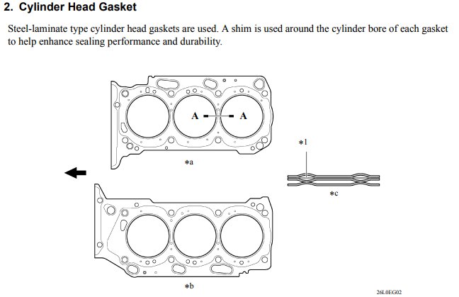

    Head Gaskets are MLS, I can't find an image of them, but they may already contain an integral o-ring, similar to what Subaru uses on their EJ257 engines. @OVTune is the current guinea pig, and he will find a limiting factor on one, or many, parts of the engine or transmission, but you are correct. As the saying goes, pay to play. I'm a few years out until I can even think about buying this kit, so I will continue following the progress until I can afford one, or until it is determined that FI is not a great idea for our trucks.

    Head gaskets are rarely, if ever limiting factors on cars these days. Almost all cars come with MLS head gaskets. The old days of graphite layered head gaskets were the ones that would fail. You're more likely to melt a piston than blow a MLS head gasket
