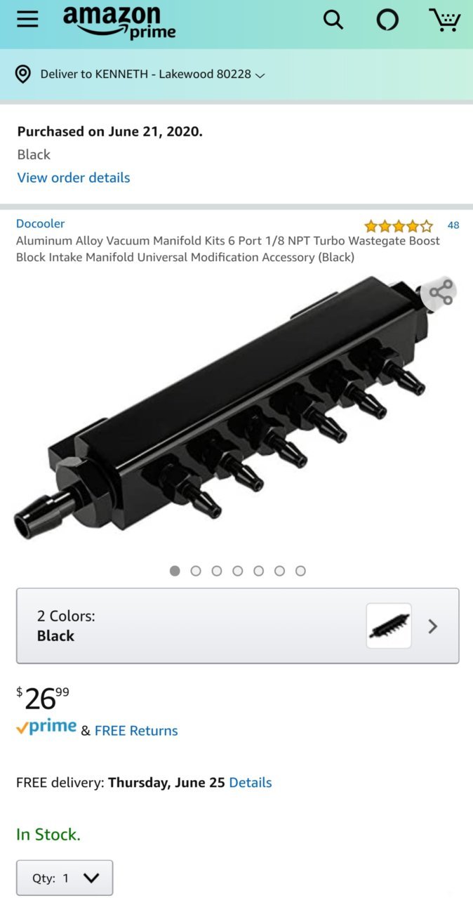

    I was under my hood this morning thinking about finishing my gauge install. I was looking at the vacuum port on the driver's side which just so happened to be the pcv line. I wonder if this is where he was planning on plumbing in the bypass valves. If that's the case, an oil separator on the pcv side of the bypass valves might be a good idea

    The line for the bypass valve comes off the front of the intake manifold, the gas tank purge solenoid.
    The hose off the PVC is setup with a check valve with the kit, so boost cannot go into the engine.

    Is the kit coming with a vacuum manifold or just Ts? Also what size is that hose?

    For the line you are plumbing the bypass valve in on. If it is just coming with Ts I might put in a manifold that way I can run the bypass valves and boost gauge on the same line and make it nice and clean and out of the way.
    Something like that.
    We are talking about that hose right?

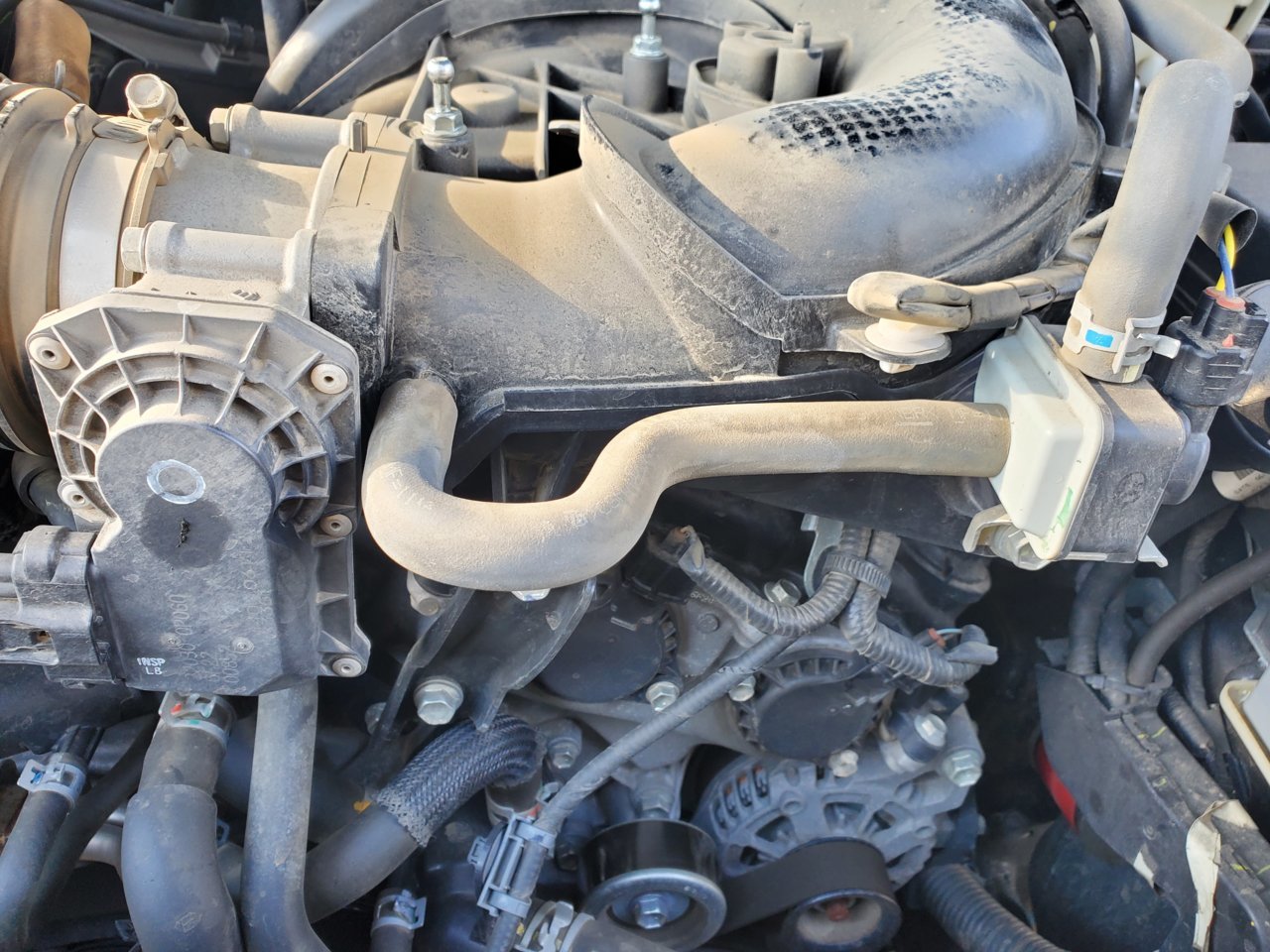

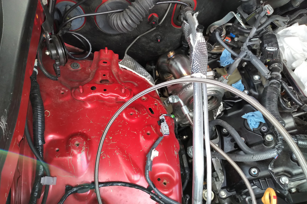

    So I've been putting my R/D truck back together while doing the instructions.
    Should be wrapped up tomorrow, so definitely videos this weekend.
    Just waiting on a few pieces to get here to ship out the first few kits!
    Ignore how beat up my engine bay is. My truck went through he'll and then some testing fitment, turbos in, out, in out, etc.

    Hopefully this helps with you guys who have something mounted over there?

    Think any insulation would be necessary/ beneficial?

    It's definitely getting fully wrapped in heat shielding. These pics I took days ago, never got around to uploading them.
    The kit comes with sticky sided heat shielding
    FYI some stuff I did to my truck is *not required* to be done, it was just done when testing *other* stuff.
    like the coolant hoses that replace the metal tubes that wrap around the engine. Those shouldn't need replaced, they were required for the supercharger, I never swapped them back, moving the brake lines on this side, etc

    Are these the base turbos?
