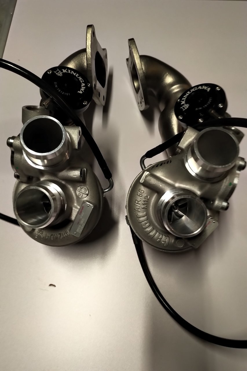

  16. Jun 24, 2020 at 1:44 PM
    #8036
    OVTune
    OVTune [OP] Well-Known Member
    Mar 27, 2017
    #214557
    8,112
    OVTune
    I haven't sent out emails regarding fueling options yet.
    Still collecting and preparing pieces. Our billet CNC oil drains are done, will get you pics of those tonight.
    Really trying to make this a bolt on 1 time and done type of deal.
    Believe me I have went through shit and then some testing drains, fitment, oil leaks, leak, leak, that works, that doesn't, etc.
    You'd *think* oh simple oil drain hose from turbo to pan. Hah, except these turbos use a tiny drain hole so I had to design the oiling system different (thank God garret was kind enough to add a side feed oil port on to the turbos...for what reason who knows) but rather than using the oil pressure line AND drain line on bottom, our new setup uses side feed port + custom CNC'd lower that blocks the OE pressure hole. It's nice and works fantastic and makes install of the oiling portion a heck of a lot easier.
    But that also means, for some of you guys asking, that NO ford turbo option is usable on this kit. (It never was really designed to use a Ford version anyway). Just a FYI.
    There has been some here and there updates that I just haven't got to post yet.
    Redesign on wastegate brackets
    Redesign on oiling
    Etc
    All of which are already done, did it back in march/april.
    Probably best part of all is that you can drop the turbos and manifolds, mounted together in at once.
    And servicing is so easy.
    Remove the 10mm bolt off the exhaust housing, disconnect wastegate arm and couplers, pull turbo CHRA + cold side right off.
    Not that servicing is neede
    AKGSD, Quadabaum, CO_Taco125 and 18 others like this.
