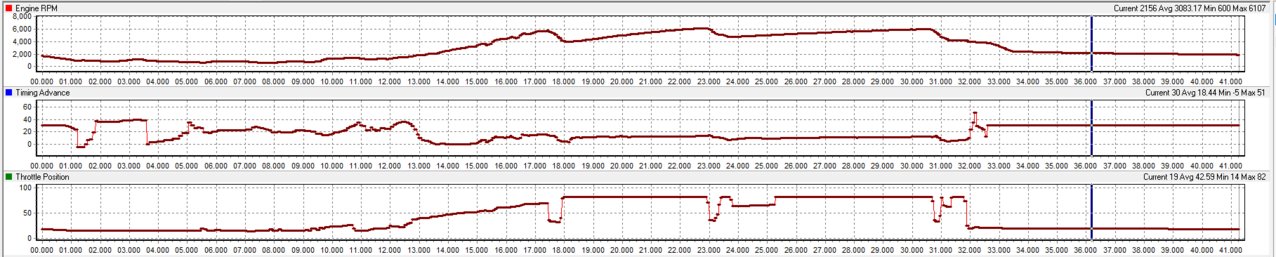

    Have a lot more videos coming.
    quick video trying to show acceleration from a stop to about 95mph.
    traction control still engaging in first when it starts spinning as you can see, cutting throttle (you hear the bpv twice)
    video isn't edited or anything nice atm.
    The turbos feel barely alive @ 7psi
    powermax, about 7psi.
    https://www.youtube.com/watch?v=iL1j0DjX0zY&feature=youtu.be
    and youtube makes my 4k video look like a potato.
    log >
    traction control simply wont let you give it all in first

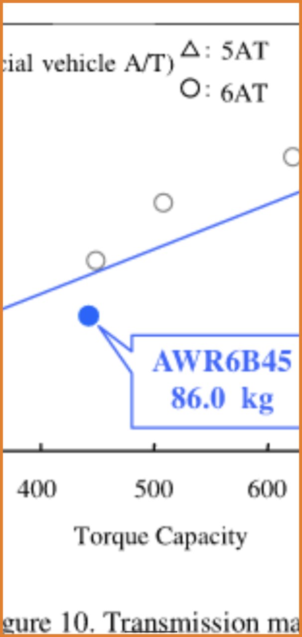

    How much power can transmission, transfer case and rear end all handle without reliability concerns?
    Tea-coma likes this.
  11. Jul 10, 2020 at 7:19 PM
    #8191
    soggyBottom
    soggyBottom Well-Known Member
    Sep 19, 2018
    #266818
    2,023
    I recall the transmission being "rated" for somewhere in the low 300s ft/lbs

    how do they find this number?
    My assumption is most of these numbers are provided by completely binding the trans until it breaks under a certain torque load?

    Idk, they make tranny dynos. There's a dude on YouTube with a AB60 tundra trans on the Dyno.
  20. Jul 11, 2020 at 3:21 AM
    #8200
    soggyBottom
    Sep 19, 2018
    #266818
    2,023
    These numbers are likely based on safety and a given lifespan. With enough use, everything will fail even when used properly. Increasing power will inevitably make that failure a bit sooner but I don think there is too much to worry about here.
    Safety margins are everything. No one builds something that is going to fail at the rated spec. A common value is "1.5" which means that if the design was 100ft lbs, it would be slightly over engineered to hold 150. Seat belts and rockets are both interesting on this topic. Seat belts have a margin of something like 20. In contrast, space travel is very expensive so they often use 1.1 or less.
    My guess is that the transmission is somewhere around 2 or 2.5 (640 to 800 ft lbs) however this is just a guess. Also note that this would not be a working limit but rather an absolute limit.
