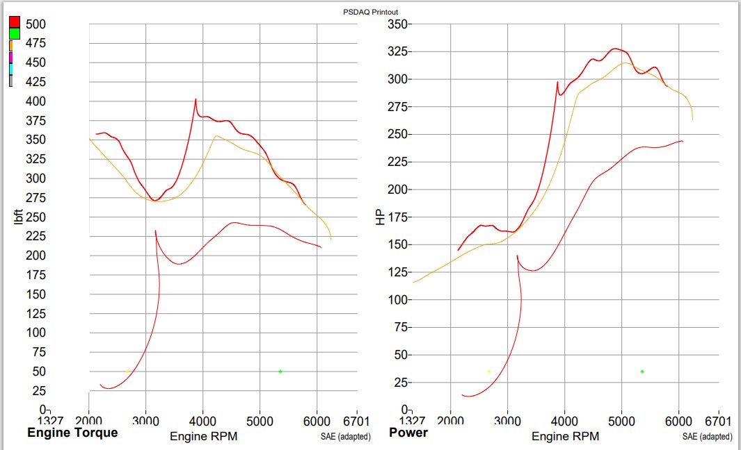

    Powermax vs Base vs stock

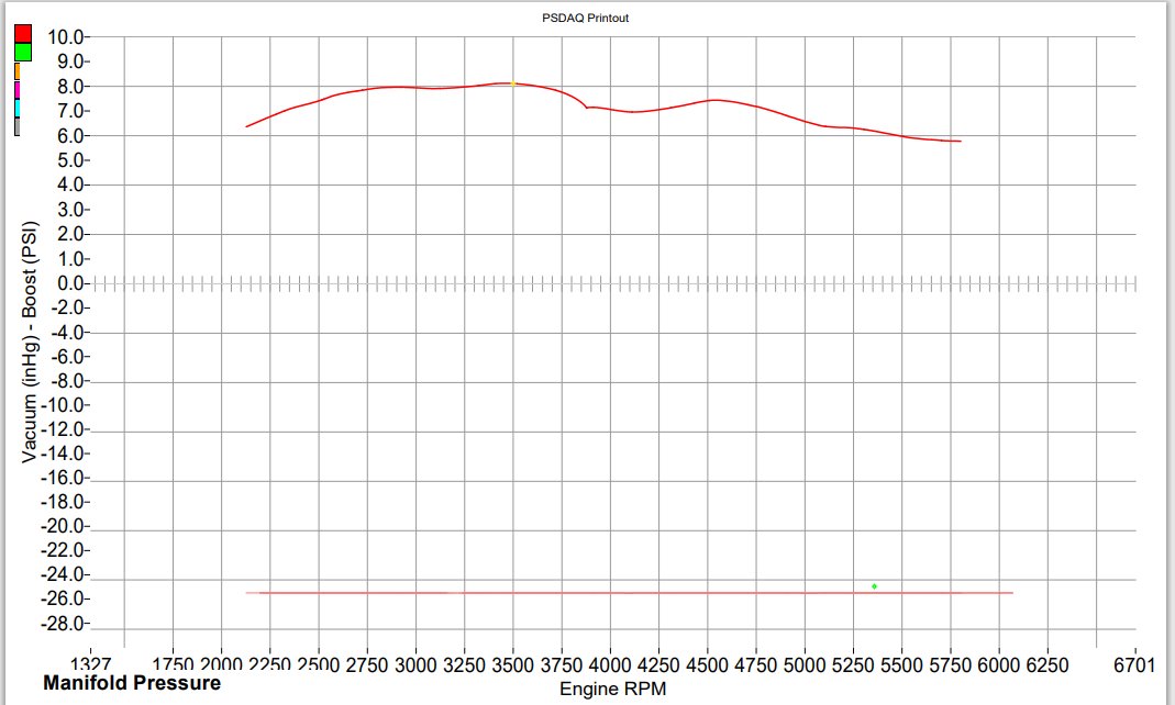

    Tested @ 7psi springs which peak boost measured was right about 8psi measured on the dyno.
    Also. I finally figured out what this torque hole is.
    First I thought it was the ACIS, however modifying valve activation did nothing.
    then I thought it was the torque converter, with full locking making *some* difference.
    But what it actually is....... is the truck applying the brakes.. even with all traction control turned completely off.
    Unlike a roller dyno that will keep wheels speeds matched, my dynapack lets each hub spin completely independent of eachother.
    When this happens the ECU is applying the brakes to get it back within margin, because there is slip.
    (this result wont happen on a roller dyno btw).

    So what you're saying is even though you have "disabled" traction control by long pressing the button, the Skid Control ECU still nannies you by keeping the wheel speed differential in check? Insane. So theoretically you couldn't even do a 1-wheel peel if you wanted to?

    Yes however it seems to be activated by *vehicle speed* because it doesn't do it at very low speed.
    long pressing the button, short pressing the button, same effect.
    I'm actually quite mad because I've tried to *tune* that torque hole out forever.

    I remember that from that hole from the first dyno runs, and even though you were able to get rid of some of it, it never did go away. Glad you finally found the cause and that it doesn't have any effect on "real world" performance.
    How are you disabling, unplug the Skid Control ECU, Christmas tree lights be damned?

    Yeah that's kinda shitty all that time tinkering and going back to the drawing board I'm sure you counted the hours to come and find it is nothing do to with tuning

    Matt,
    I am fairly certain traction control kicks back on at a certain speed (>20mph) even after it is disabled.
