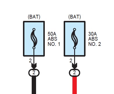

    The only way I know of that *may* work is to pull the fuses. @BigWhiteTRD explored this when looking into locker anytime.
    Be prepared for plenty of errors and warning lights on the dash. Cruise control will not work, among other things probably.

    Per my memory, also expect to loose all 4wd mode changes (based on my tests on my OR) when pulling power to the skid control.

    to eliminate the traction control i wouldn't pull the fuse i would wire a switch inline so it could be turned off whenever without the permanent Christmas dash.
