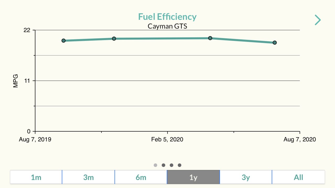

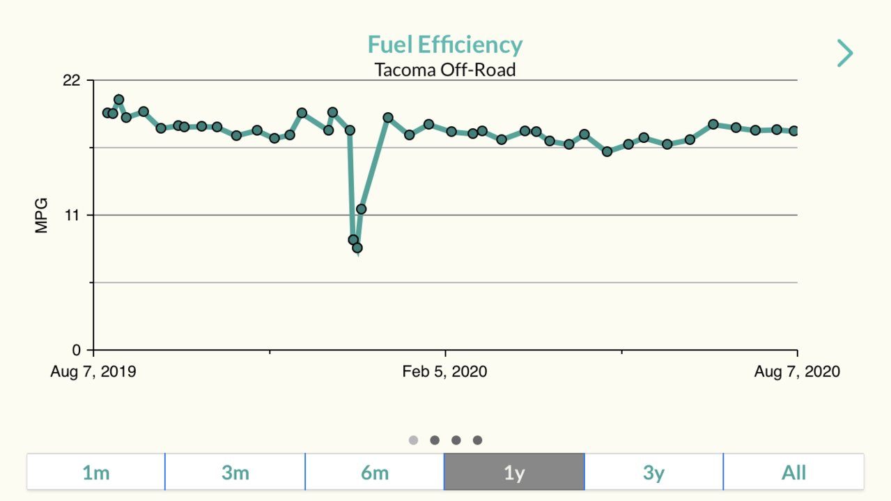

    One year of fill-ups in the Tacoma and Cayman.

    I find it easy to just log the data while I’m filling up. It doesn’t hurt and perhaps I might catch a change in performance that’s a leading indicator for something bad.
