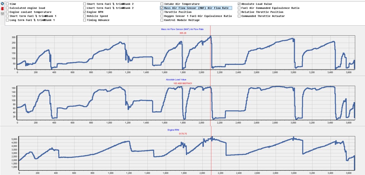

    Is >300 g/sec still within the range of the sensor with enough resolution? Does that correlate to upper frequency output range? Glad to see you having a bit more time to dedicate to tuning!

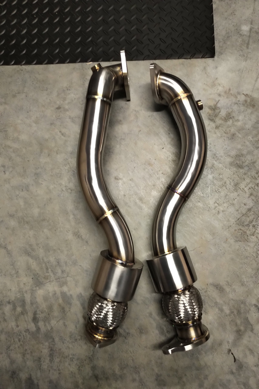

    an update regarding kits, shipping time frame, etc.
    Nearly all components are here, and we have begun shipping on some orders (mainly kits that are partial like without intercooler, or people ordering who are doing some highly customized setups.)
    All our fuel pump controllers are here and are being setup.
    Turbos, manifolds, downpipes, etc all are here (catless).
    First set of catted downpipes will be here for our approval.
    The reason the catted downpipes took so long is a custom Catalyst had to be made due to space and size constraints.
    So, our catted downpipes will be here soon and we will be expanding on orders shipping out.
    This first 25x batch is a little bit of a challenge due to the components all arriving at different times (and some things were delayed). But no worries it's all coming together.
    I do want to thank everyone for their patience, and we are very excited to start getting these on trucks.
    With that being said. Unfortunately after these initial kits are shipped out, the price of the turbo kit is likely to go up. Cost of manufacturing is going up, and ensuring that all of our components are made in the USA makes it a challenge to maintain the current price.
    So, for the initial order guys, you being the first batch adopters you have nothing to worry about price wise.
    But there will be some price changes for the kit when we start taking more orders.
    (for example the initial quote on the catted downpipe price doubled on our cost due to the cat having to be *custom made*).

    Catted down pipes
