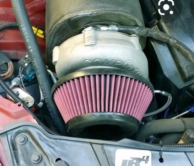

    Thoughts on turbo filters when on dusty trails?

    That won’t work, unfortunately. Pre turbo flow has to go through stock MAF sensor; which is part of the OEM air box.
    Torspd likes this.

    Any concerns with offroad dusty conditions?
  14. Aug 13, 2020 at 12:46 PM
    #8734
    JamesT
    JamesT Well-Known Member
    May 26, 2020
    #329438
    261
    2018 TRD Pro, MT
    These are running off of the stock airbox and filter. No less a concern than factory. If you are worried, get a snorkel that works with the factory airbox.
    Skydvrr and Tea-coma[QUOTED] like this.

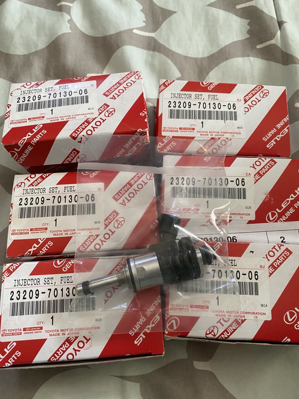

    My injectors are in! I ordered mark 1 but they sent me what was available. Looks like mark 6.
    Torspd, GillyLink, Tea-coma and 3 others like this.

    Nice! I got the mark 6’s on their way as well.

    Curious how the instructions will look for DI replacement. Seems pretty in-depth and technical.
  19. Aug 13, 2020 at 7:07 PM
    #8739
    RedLantern
    RedLantern Well-Known Member
    Dec 7, 2012
    #92641
    1,771
    Honolulu, Hi
    2019 TRD Pro Tacoma - Voodoo Blue / 06 double cab PreRunner Turbocharged (sold)
    Should be same process as regular fuel injectors, I’m sure it’s pretty easy. Can’t really mess up. By looking at it, it probably clips to the fuel rail.
  20. Aug 13, 2020 at 7:09 PM
    #8740
    Skydvrr
    Skydvrr IG: @kalopsianick
    Sep 13, 2017
    #229889
    12,653
    Nick
    YMH
    Black '17 OR
    I just imagined them buried deep in the motor like a diesel. Tbf, I truly don't know.
