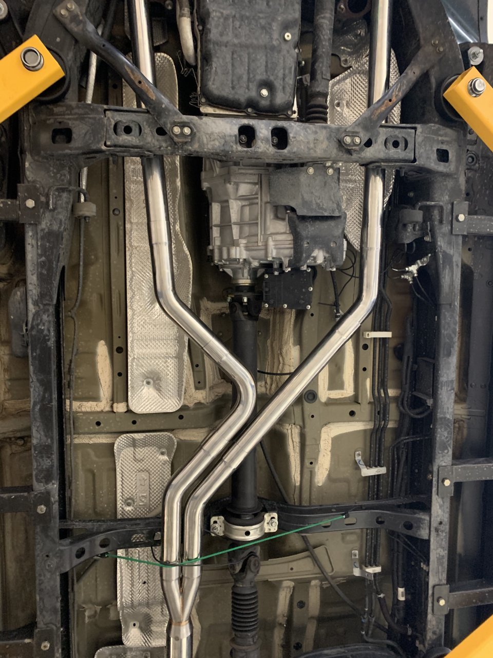

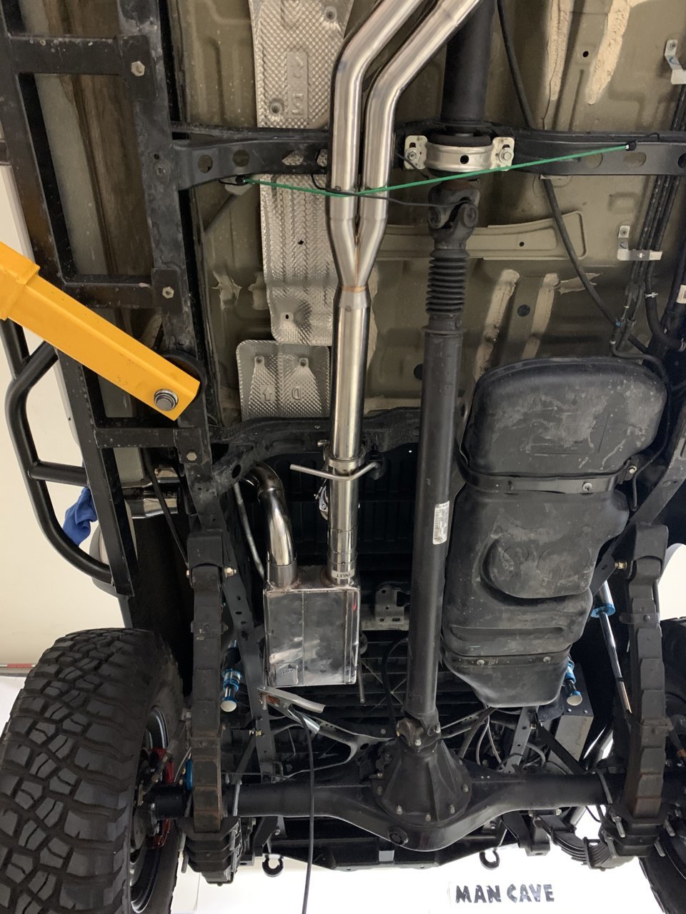

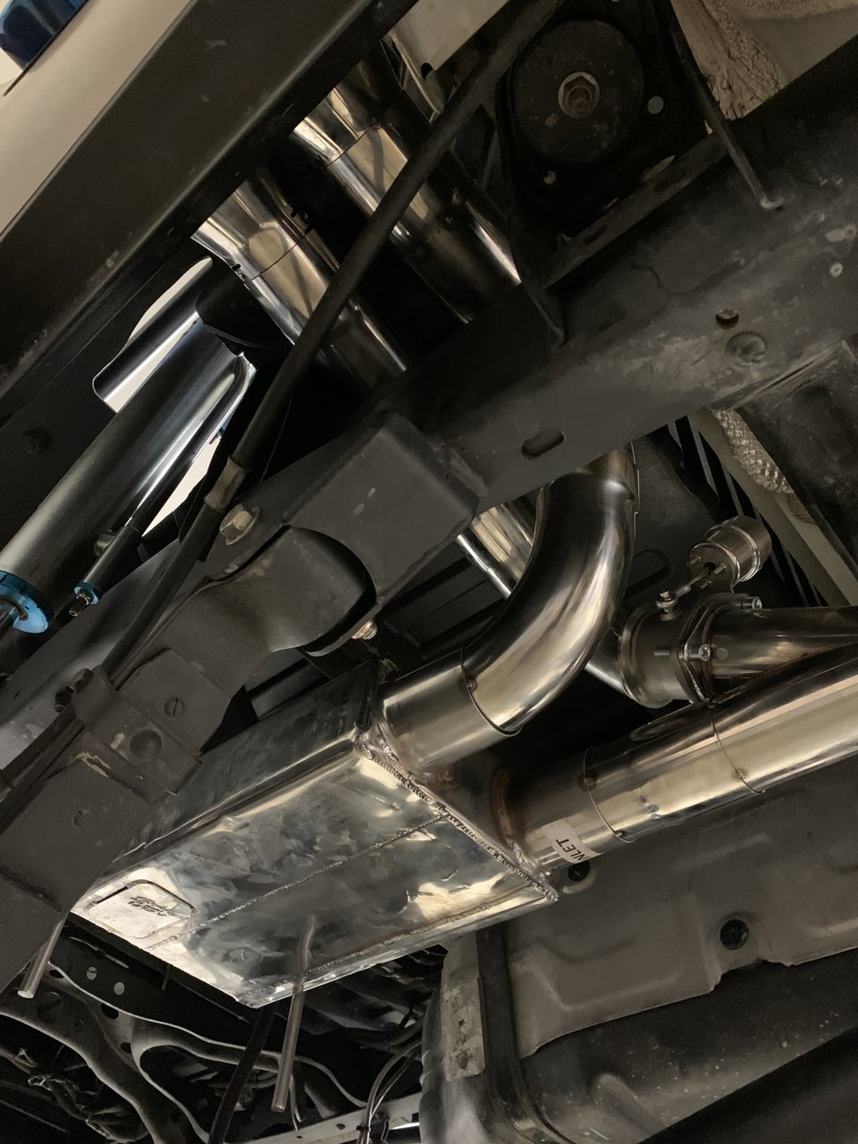

    Lots of slip joints. Leaving as is, or adding additional flanges?

    Yeah...the slips weren’t my first choice, but I have to remember this is just a truck, not my show car. They will still get finished off backpurged/tig welded. It’s basically 3 parts; Downpipes, Midpipe(1 piece to the back of the cab), and the rear muffler/bypass contraption. I reused some stock hangars, as well as have some new ones to add. I’m hoping the flex couplers in mats downpipe should give it enough room For movement.
    Can’t wait to hear this baby open dumps :eek:

    Keeping one set of slip joints, since staying with them, will be good for having a removable section. Pretty sure you already thought about that though. Such as the section of y-pipe to muffler flange.
