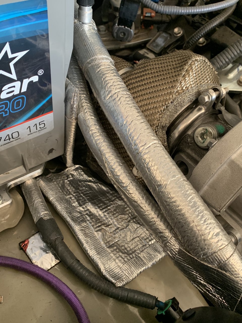

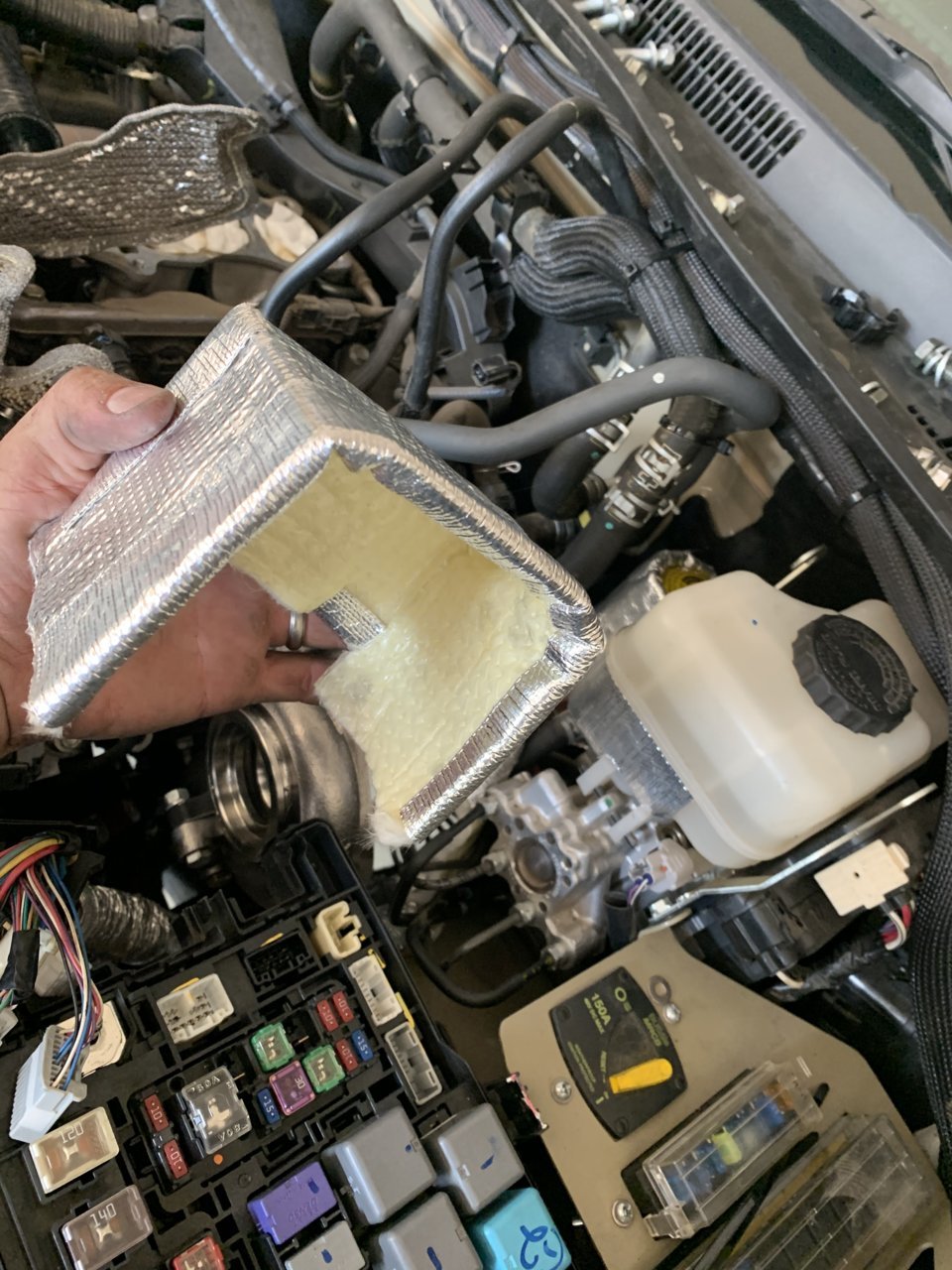

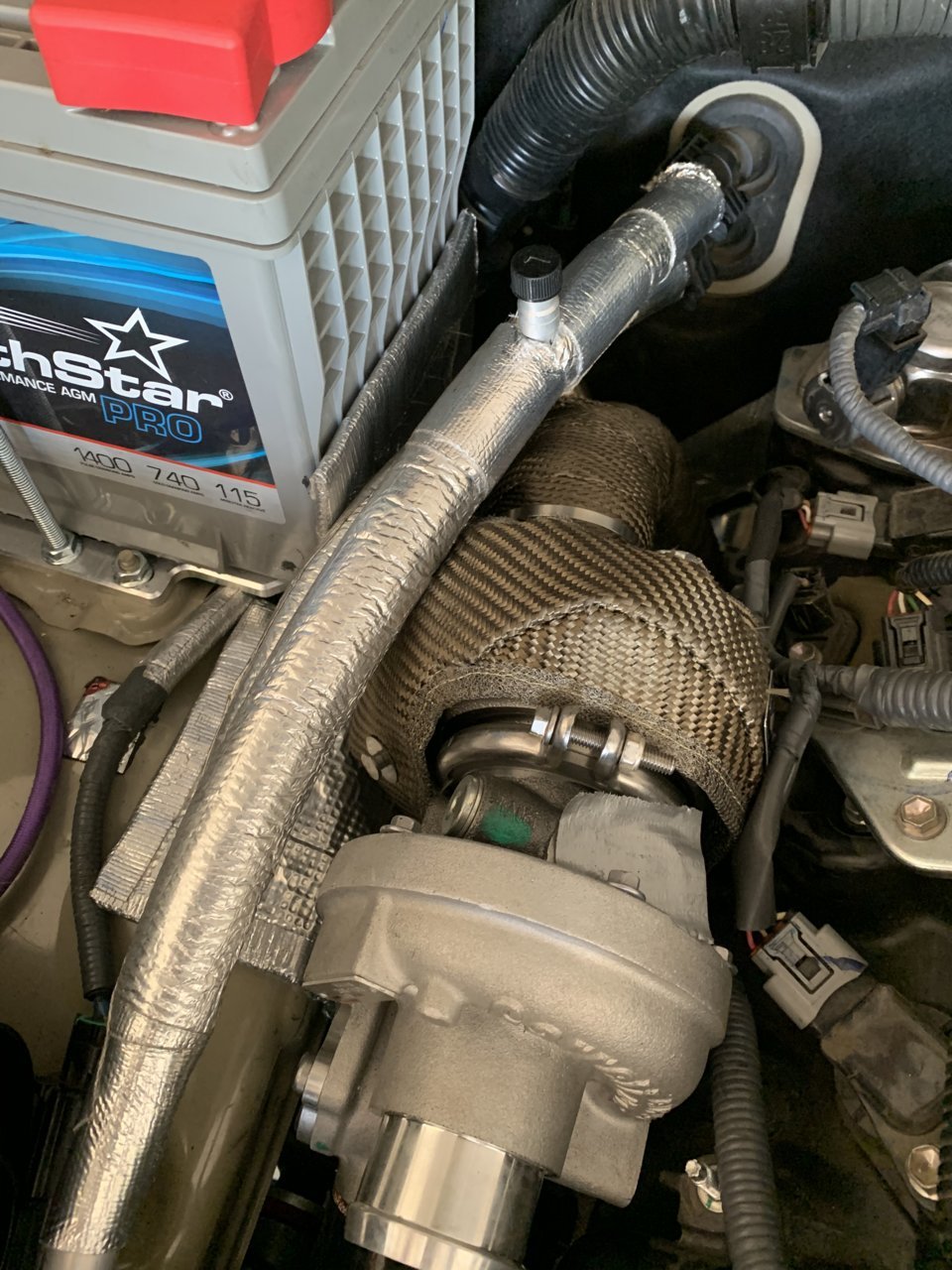

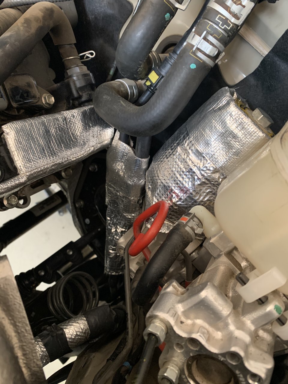

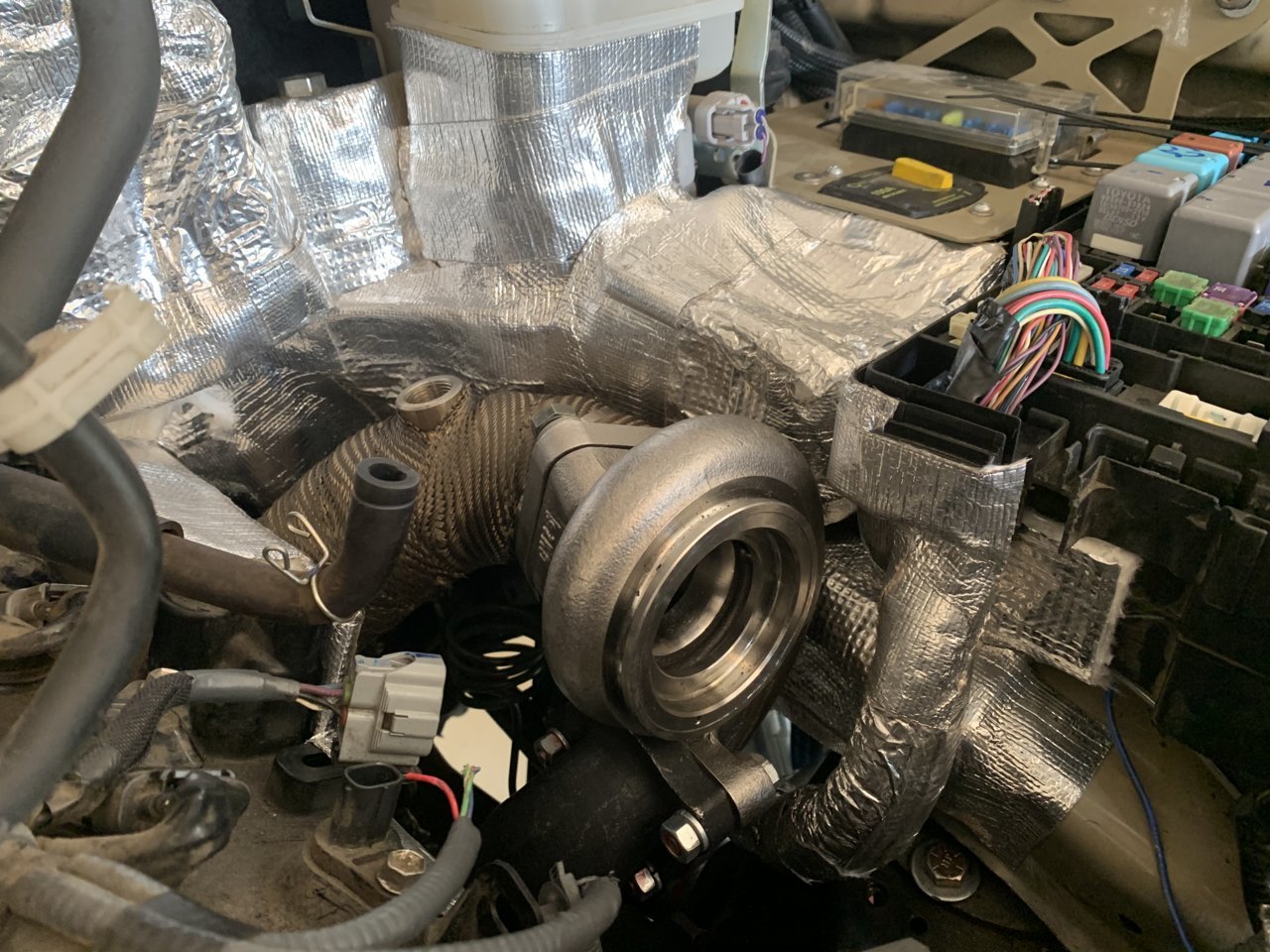

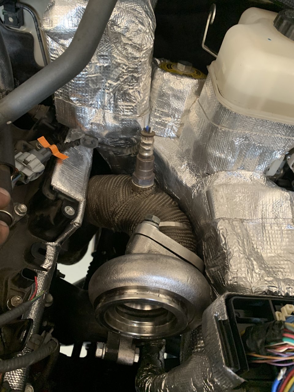

    o_O.. all this heat prevention :bananadead: talk around thousands of dollars in electronics and brake equipment boiling while you drive. Seems risky. All turbos glow red when towing or up a big hill. Seems to risky.. :tumbleweed: I crawl and slow 4x4 quite a bit with my truck so maybe supercharger or just gearing going to be the way to go for me. Meso's compartment looks like a SpaceX rocket engine bay.
    Not an expert in thermodynamics, but logic tells me if you are deflecting all the heat @MESO and @OVTune , can't this make the heat super intense inside the turbo. Where will the heat dissipate if it can't leave the turbos or around the turbo?
    Look forward to seeing the results of Mat's hard work in your rigs. Great turbo solution. I just don't know about the turbo location. :rolleyes:

    It'll be fine. In reality the turbo blanket alone would suffice. It'll drop external temps DRASTICALLY. You could put components right up against the blanket with no concern. This is all just overkill.

    why the eye roll?
    Also, the blankets are going to keep the heat consistent, rather that blanket was on there or not the maximum temps that will be reached should be very very close.
    The blanket makes the heat want to escape to the easiest path, in this case out the exhaust.

    You want to keep the heat inside the turbo. Helps spool and efficiency. Yes,, it looks like SpaceX.. and like I said it’s probably overkill. A truck blanket should be fine. I don’t have any concerns with “thousands of dollars of electronics” getting damaged.

    Just seems a bit contradicting for you all to say it will be fine with a turbo blanket and minimal protection and then cover everything in the engine compartment when people consider both of you @MESO and @OVTune the lead example for the first installs. Just an observation. I'm going to shut up now. I was just trying to understand why you would do overkill if it was not needed is all. But I'm making MESO fanboys mad (that's a compliment MESO) so going to shut up now and be a voyeur.
