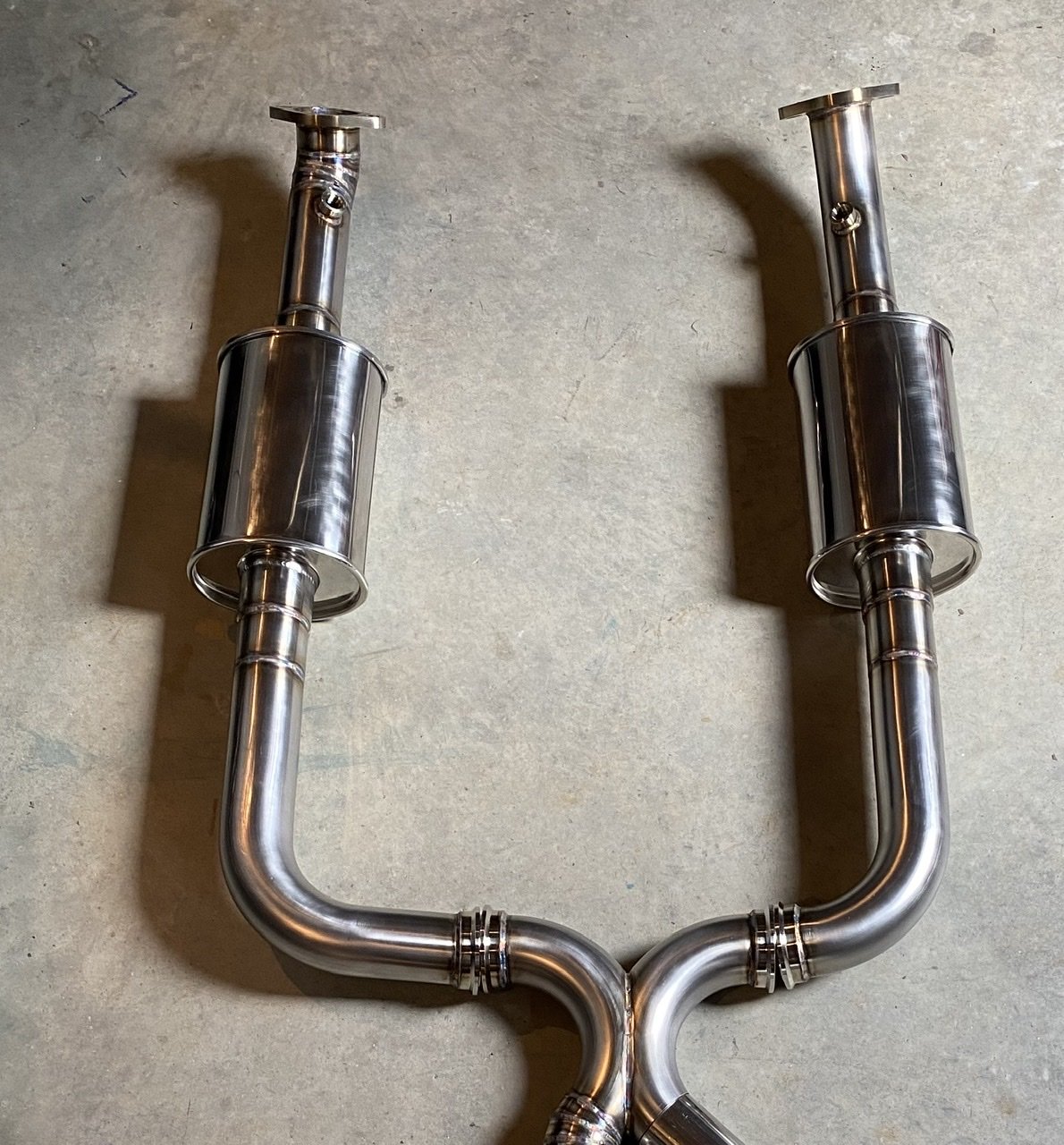

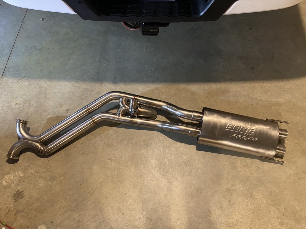

    Did somebody say overkill?? :rofl:

    When you’re twin turboing a Tacoma, nothing is overkill lol.
    Looks great..a true dual. Are those resonators or mufflers up front? And are you running and hangars besides the 2 in the back?
    Only thing I would have changed is Vband the DP’s.

    That is gonna be a quiet truck...until you get on it!

    I'd recommend anyone using exhaust wrap to seal it with one of the offered silicone sprays. I always used DEI, it helps prevent moisture from the elements of weather from destroying the exhaust wrap.

    Thanks! They are Vibrant ultra quiet resonators, straight through. Same as the Borla, straight through with an internal X pipe. I thought about the v band up front, but since the DP flange bolts to an engine block mount it keeps everything past it nice and tight. Everything sits at or higher than stock height, so with a v band up front and no solid mount I would have had to account for a bit more flex and more clearance. It’s a trade off. Yep, I still have the 2 hangers up front and one on the muffler to add. I’m adding a v band for the last section over the axle, which will be a PITA to fab.
    That’s the idea! Should have a pretty unique tone.
