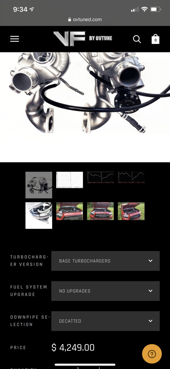

    Any ballpark price for the turbos? Might be keeping my Taco instead of the Tundra afterall so considering SC or Turbos. I remember initially the base kit was around $3800 for tuned users but it seems like the final price is gonna be quite a bit more..lol
    How much would a regular shop charge to install also?

    Due to unforeseen costs of production OVTune has to raise price. He was just generous and didn’t raise prices on the initial buyers or you can even call them investors lol. The amount of the first 25 was on the first page.
    Call up a well known performance shop and just ask what they usually charge to install a turbo kit. Should be easy to find. Ask for references on your region thread on TW or search Facebook.
    I’d say $5000 just to be safe for all parts and you installing yourself.

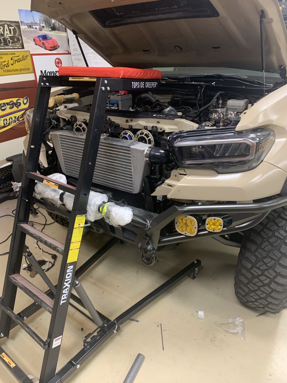

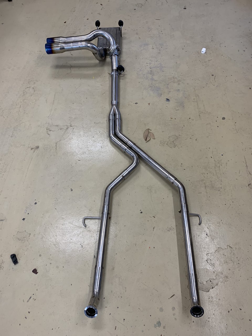

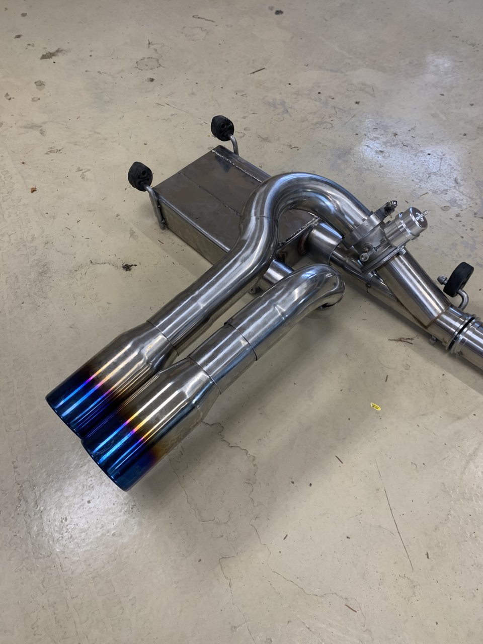

    Tackled some exhaust work tonight. All finished mocking up.. now to finish weld:pout:
    Also.. if you are working in the engine bay for an extended period of time, I HIGHLY recommend the Topside creeper. My back was aching the other night crouching over the fenders for hours. I could fall asleep on this thing :rofl:

    Quite anxious to hear the sounds that it makes.

    I'm taking screen shots of all this Exhaust Porn. I hope everyone's down with extreme plagiarism.

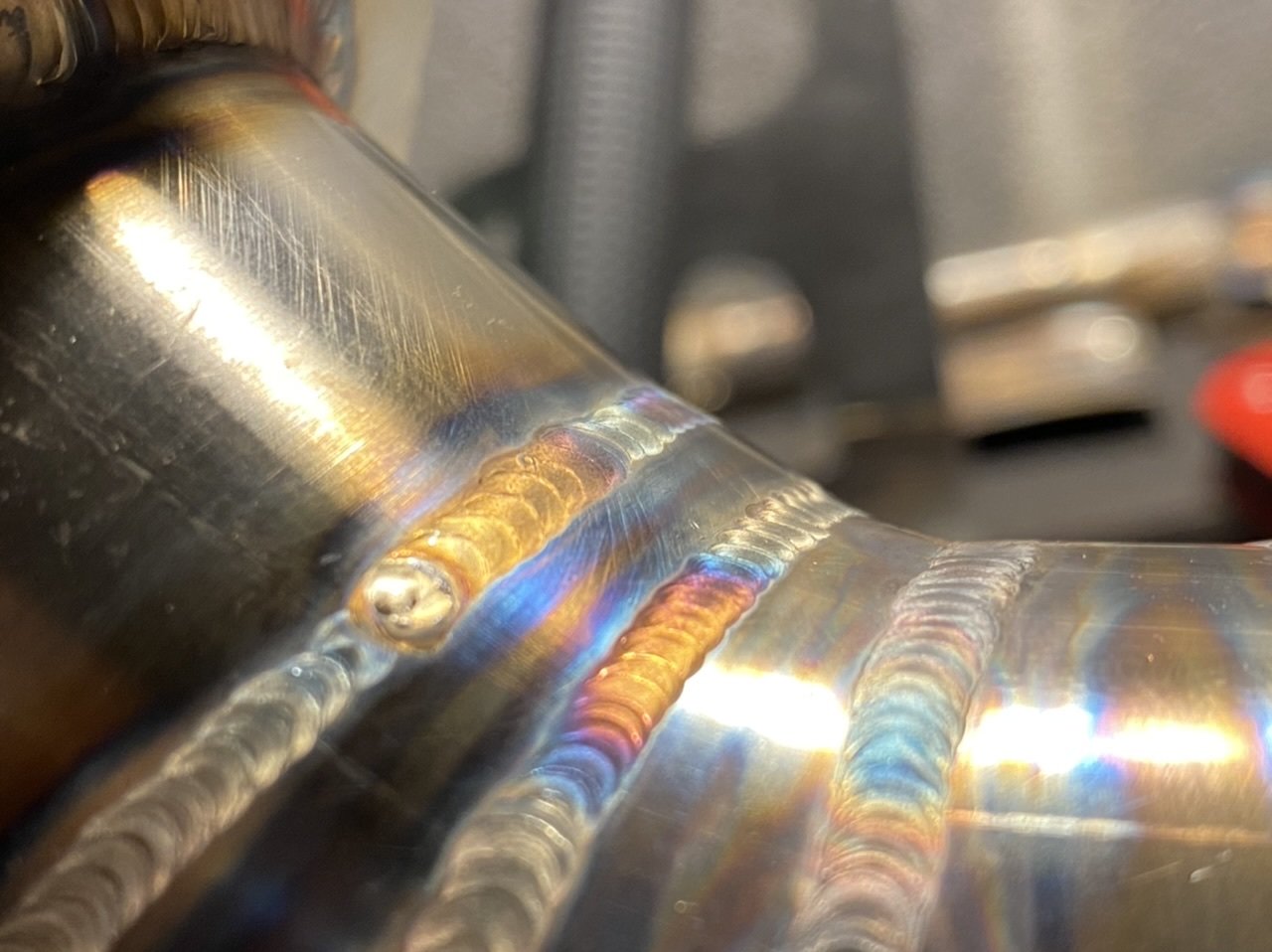

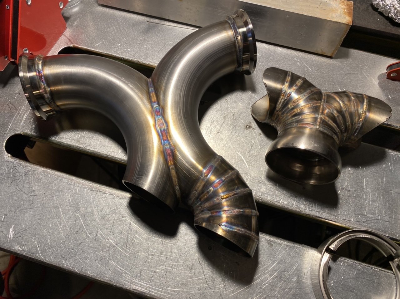

    Very nice!! Welding is the fun part!

    All autogenous, yes?

    Tig finger definitely helps on that hot stainless!

    If I have a good fit yes, otherwise .045 dabs. First time welding TIG was a month ago, still have a lot to learn!
    Yes sir! Knowing when to stop and walk away to let the part cool is the hard part!
    Doesn’t look like it, but there’s at least 10 hours in making/welding these parts.

    Those pie cuts alone would take me 10 hours haha

    Those welds looks great though
