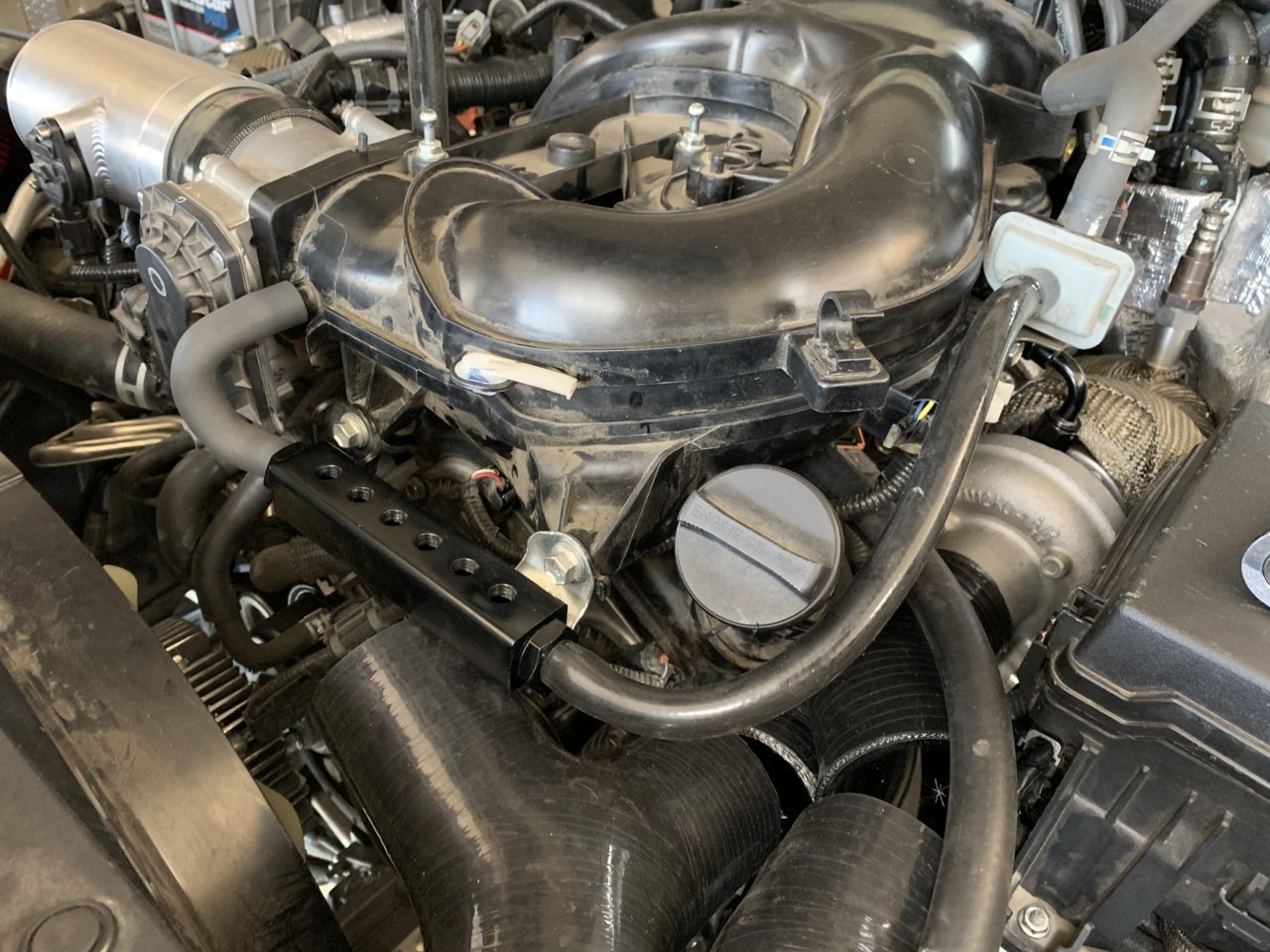

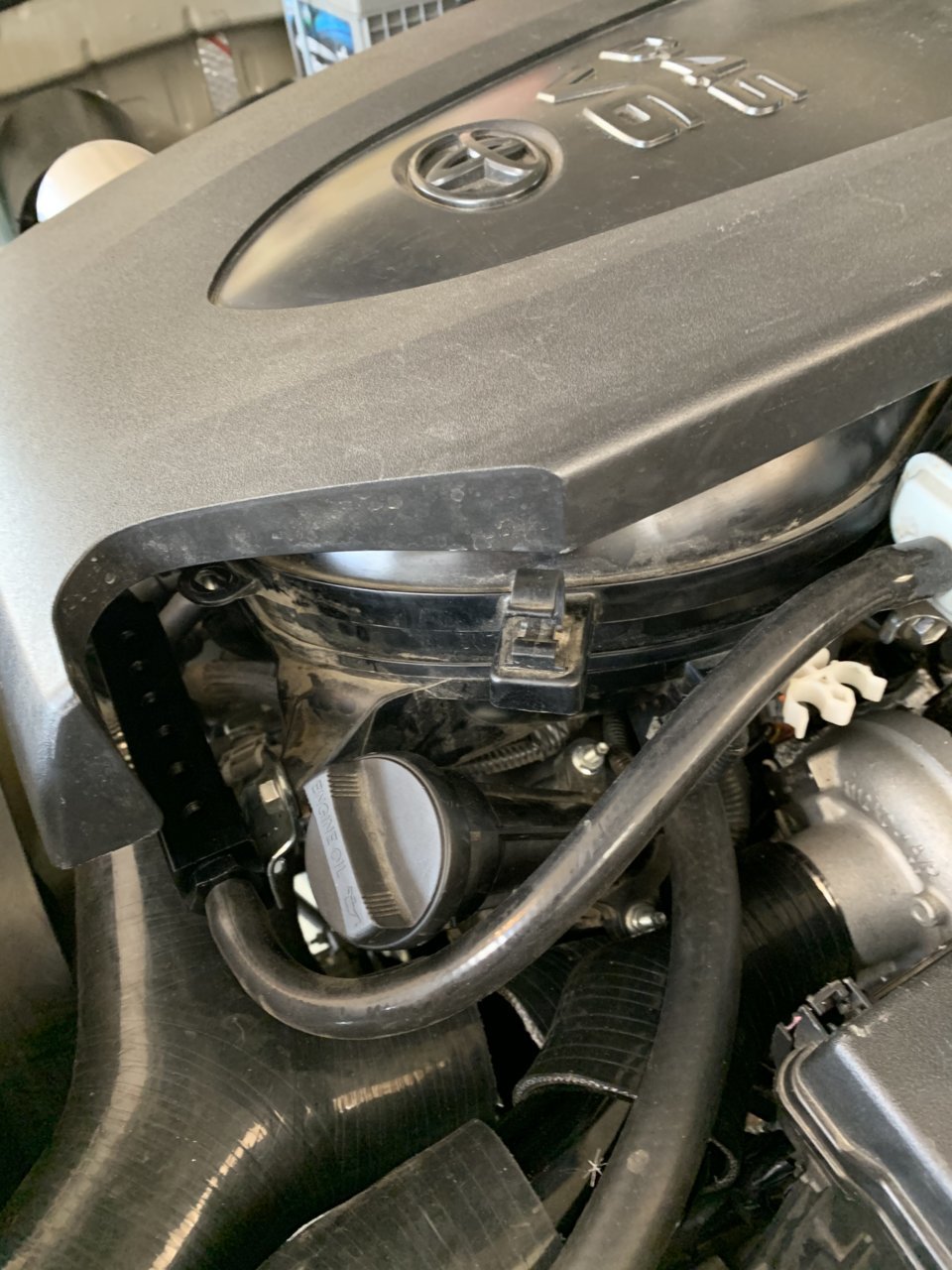

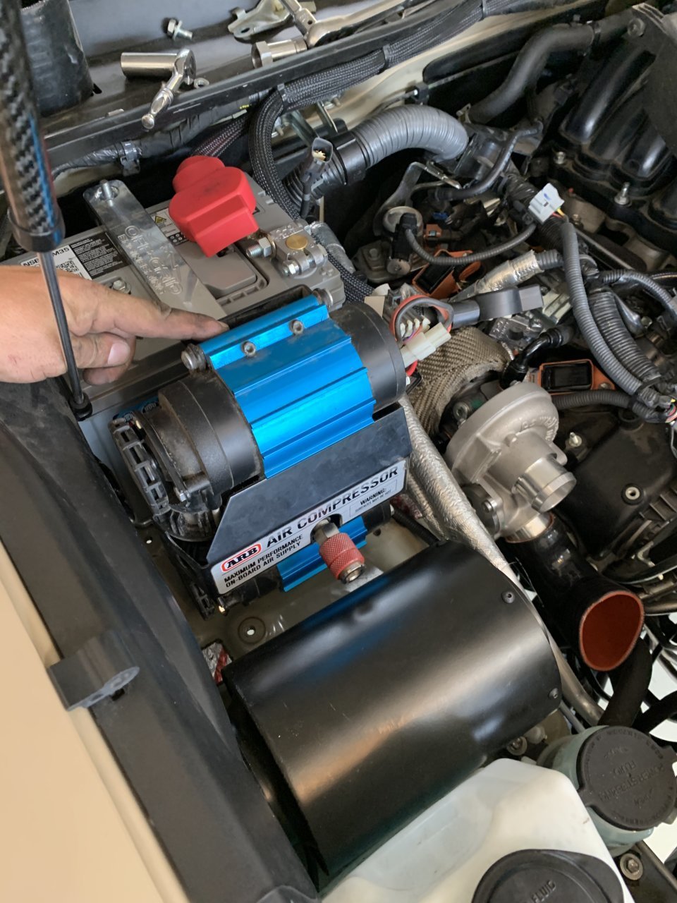

    Happy I’m able to keep my ARB compressor. Need to fab a custom mount, but at least I can have my cake and eat it too
    also, anyone looking to do a vacuum manifold..here’s how I did mine. I relocated the stock vacuum solenoid(?) back around to the drivers side. Still feeds from the stock plastic manifold but now into the 6 port(and back out to stock). Overkill as I only need 3; BOV, Boost gauge, Exhaust cutout. But room for expansion. Just made a quick bracket and bolted it to the hole where the original solenoid was mounted.
    Stock engine cover closes right over. You’d never even know :rolleyes:

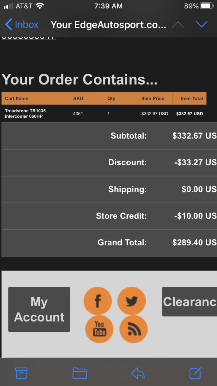

    Anyone waiting to purchase the intercooler on your own if you have a winch now is a great time from Edgeautosport.com. Got it for a great deal. You get $10 credit just for creating an account too. 78EF2107-55C7-46FD-BB04-8EE7AB24B949.jpg
