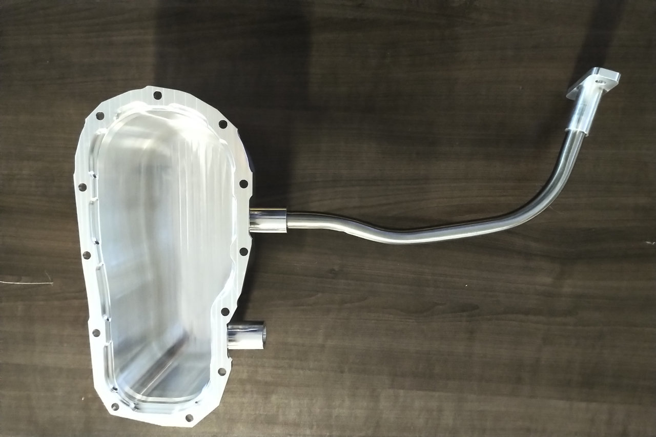

    So, something I want to show you guys in case the question comes up about how does the oil route work.
    #1. I absolutely above all else, hate oil leaks. Having excessive amountsof rubber hose can degrade, and where the hose connects is the highest chance of leaks.
    So, why does our pans and drains not have a barb style setup for the hose to go over in a traditional way? Because it isn't designed that way.
    This picture is for *example* only, but there is a bent hard line from the oil drain to the pan, that fits inside (tight fit) the drain holes.
    A small section of rubber hose goes over that for sealing and security.
    This avoids relying on just a rubber hose.

    I was totally curious why u didn't machine the Barb on the end lol. Woukd a taper fit increase security / sealing?

    I'm glad all of this was very well thought through. That was one of my biggest concerns with this kit. The possibility of oil leaks. I hate dealing with leaks. What does the oil feed side look like?

    Double O-Ring grooves on the inside or just a rubber hose on the outside?

    Oil feed side is very simple setup > use the provided adapter for the oil pressure sensor, T, and two pressure lines to the turbos.
    rubber hose over. It's a very tight fit.

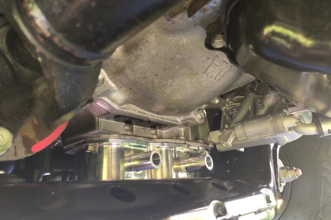

    Here's better pics of the OIL FEED. Taps down low. Unscrew the Stock Oil press sensor-->thread in the new Silver adapter-->back into pump. Then the "T" screws into the top and then both feed lines go into it.
    The "T" will need to be clocked so the fittings can clear the pump. Here's an overview. Greenbox is where it all happens. Red lines are feed to each turbo
