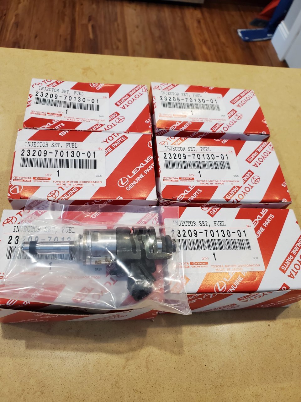

    Injectors arrived! Oddly enough when I reordered them lexus said it would take a month. I asked for a different set and magically they shipped the next day.
    MESO and Bigetaco22 like this.
