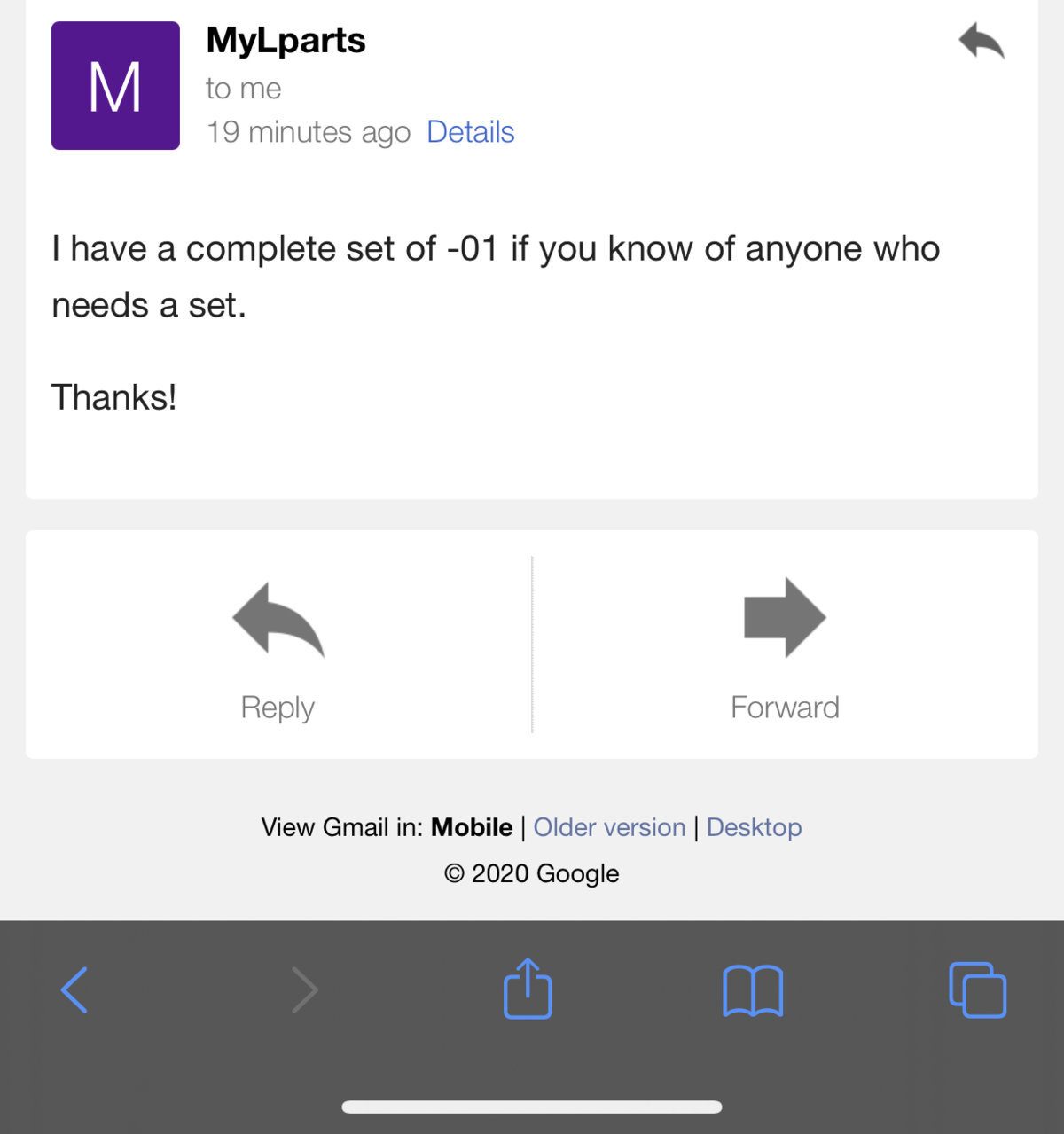

    If you haven’t sourced injectors yet, MyLparts just emailed me saying he has a full set of Mark 1 Injectors on hand. DM me and I can forward/CC the email to you if you need a set of injectors. I purchased mines from them with no issues.
    total I paid was $1,785.26 shipped with the forum discount

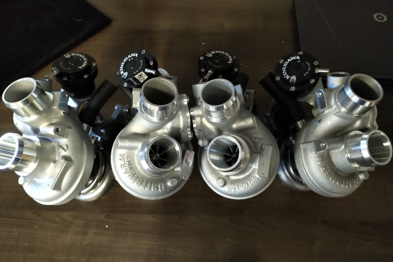

    2x base kits getting ready to go and 3x powermax kits

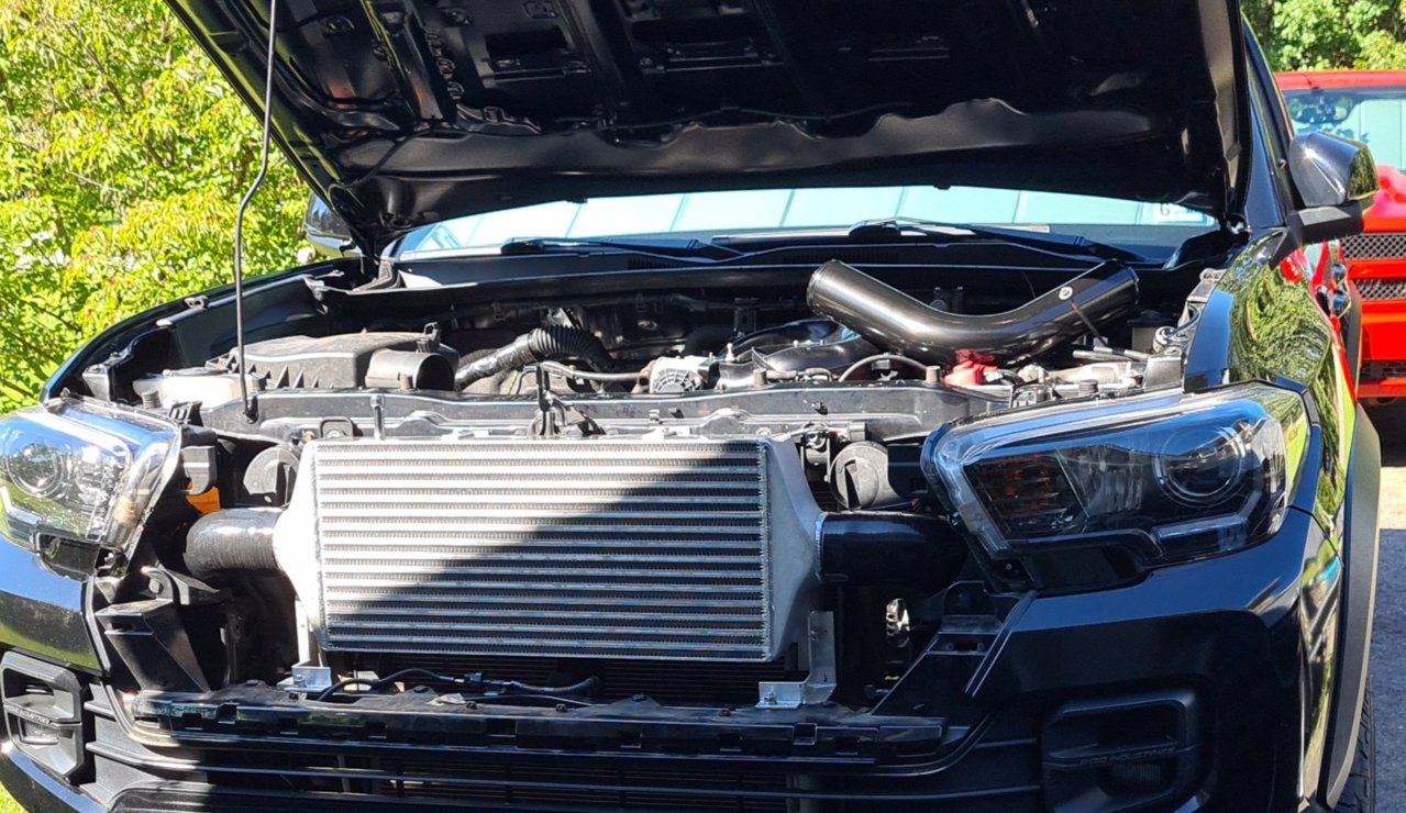

    Chomping at the bit here. The TR10C fits perfectly. I made aluminum mounts that push the lower mounts backwards to keep the entire intercooler vertical and bring it up to just below the safety release. Zero cutting or modification to the grille this way. 45 degree couplers aim the tubes perfectly behind the headlights without cutting anything. I even used existing holes in the lower and upper supports so no drilling needed.
    The only thing i had to do was relocate my horns to either side with a single wire extension on the passenger horn. Used existing holes again for this. They were in the air path anyway. I could have just bent them back but i wanted the airflow clear.
