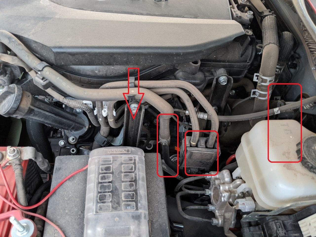

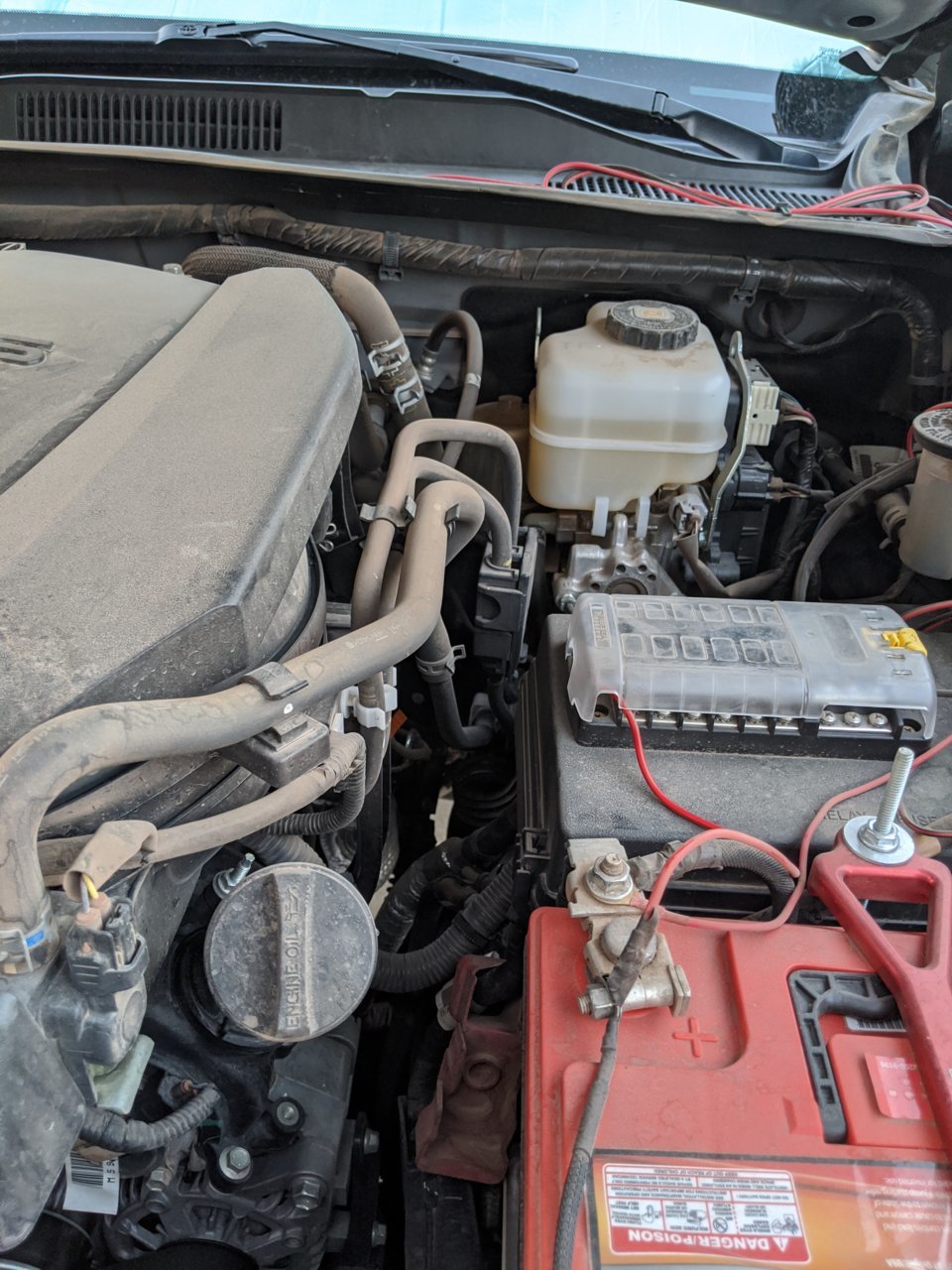

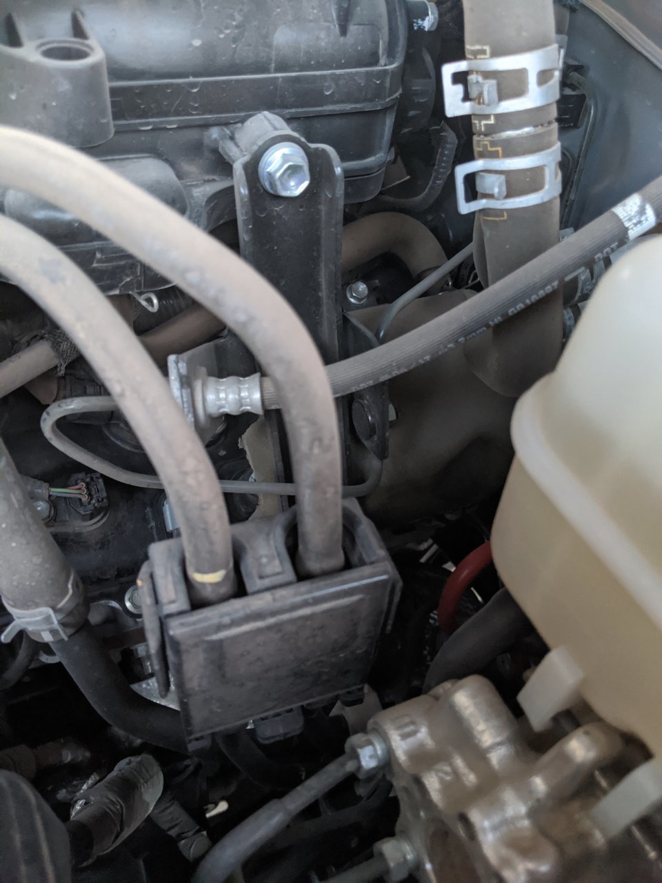

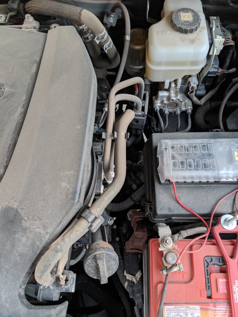

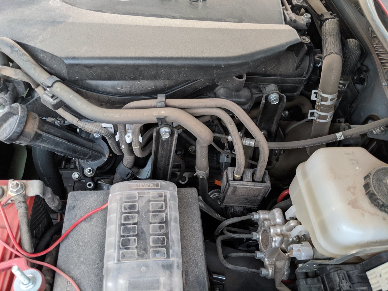

    I just went out and took these in case he doesn't see your comment

  2. Sep 20, 2020 at 6:05 PM
    #9342
    OVTune
    OVTune [OP] Well-Known Member
    Mar 27, 2017
    #214557
    8,112
    OVTune
    Nope, should be fine, but will make installing the downpipe a little trickier.

  3. Sep 20, 2020 at 6:07 PM
    #9343
    BlkdOuT
    BlkdOuT Well-Known Member
    Mar 24, 2018
    #248275
    257
    2017 Tacoma trd sport 4x4 MT TT
    When I did my catless dp's the driver side was a bit of a tight squeeze but not that bad. Catted will be another story
  4. Sep 20, 2020 at 6:08 PM
    #9344
    mZiggy
    mZiggy Honey badger
    Apr 8, 2017
    #215707
    4,709
    Marc
    2020 MGM Tundra SR5; 2020 4R TRD Pro; 2008 4R SR5 v8
    These damn catted pipes are going to give me gray hair lol
  5. Sep 20, 2020 at 6:11 PM
    #9345
    OVTune
    Mar 27, 2017
    #214557
    8,112
    OVTune
    the lines in red get moved to the box in the back (red) and the bracket (red arrow) gets moved, but that clutch line doesn't look like its in the way of anything.
    You will want to put a bit of heat shielding on it though

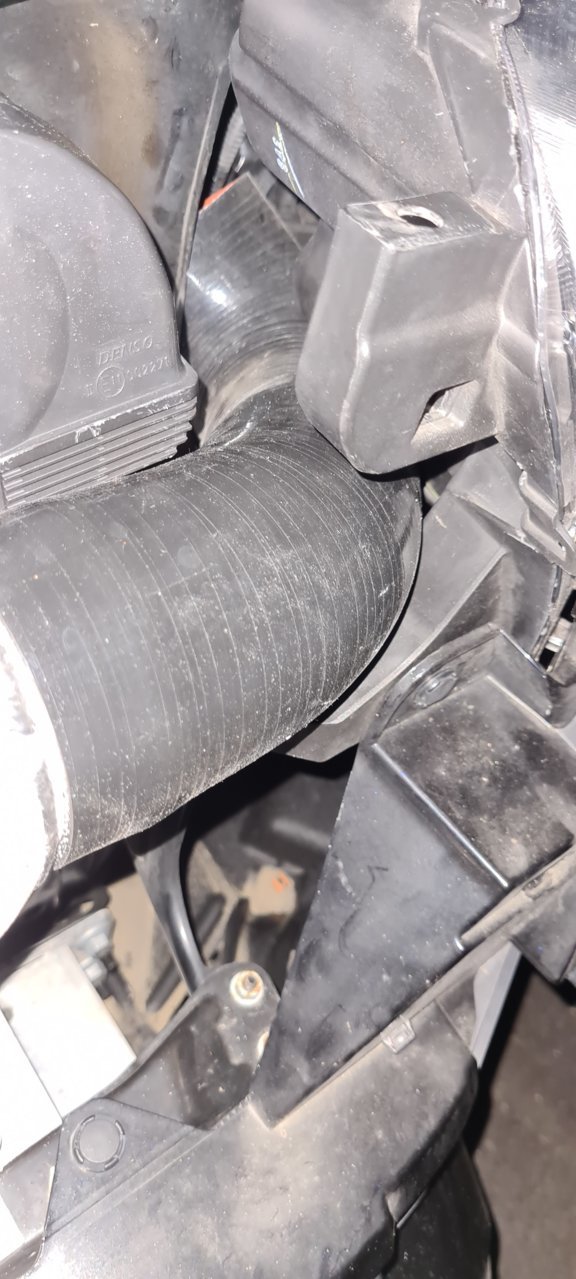

    It's not likely to cause any noticeable difference. The negative effect on the airflow will be minimal. Slight air turbulence or pressure build up as the air hits the intercooler at an angle, but on a truck i hightly doubt it will have an effect. Drag will be less of a concern than the shaking of driving a pickup over 90.
    Interestingly enough they did a study on this on military aircraft with turbocharged engines (WW2 era) and found that it didn't make a difference at low angles.

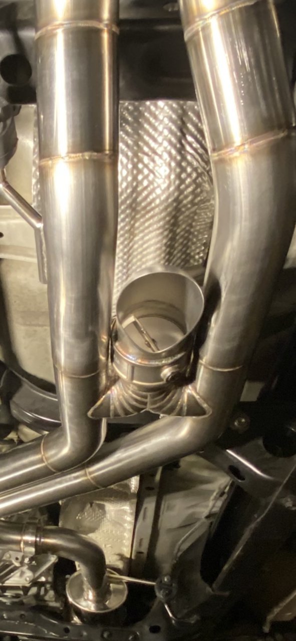

  7. Sep 20, 2020 at 8:26 PM
    #9347
    rj_taco
    rj_taco Well-Known Member
    Feb 28, 2017
    #211935
    240
    Jrgymie, bbrown, Justin85 and 9 others like this.

    If you can then you might as well.
  10. Sep 20, 2020 at 8:56 PM
    #9350
    RedLantern
    RedLantern Well-Known Member
    Dec 7, 2012
    #92641
    1,778
    Honolulu, Hi
    2019 TRD Pro Tacoma - Voodoo Blue / 06 double cab PreRunner Turbocharged (sold)
    Not sure if it’s the camera but That setup is pretty quiet. Sounds nice though!

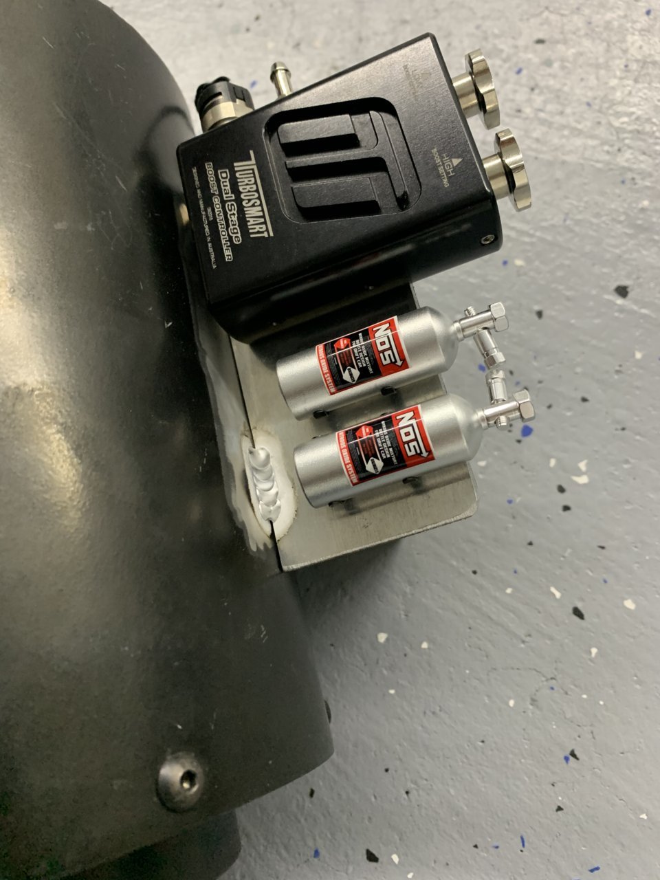

  11. Sep 20, 2020 at 9:09 PM
    #9351
    MESO
    MESO Major Modder Vendor
    Feb 16, 2015
    #148809
    16,292
    State of Jefferson
    2016 DCLB TRD HELLCAT SWAP
    You should be good. If anything might have to push that hardline a little closer to the center.
    DEF wrap the soft line with some heat protection.
    Here’s a better close up of where DP/hot side are in relation to the block
    Not too shabby. Now hit the dump!!!!!
    The only affect having it angled Will be to your OCD, not performance ;)
    DUAL TURBOS, DUAL SNORKS, DUAL STAGE, DUAL NOS.
    yes.

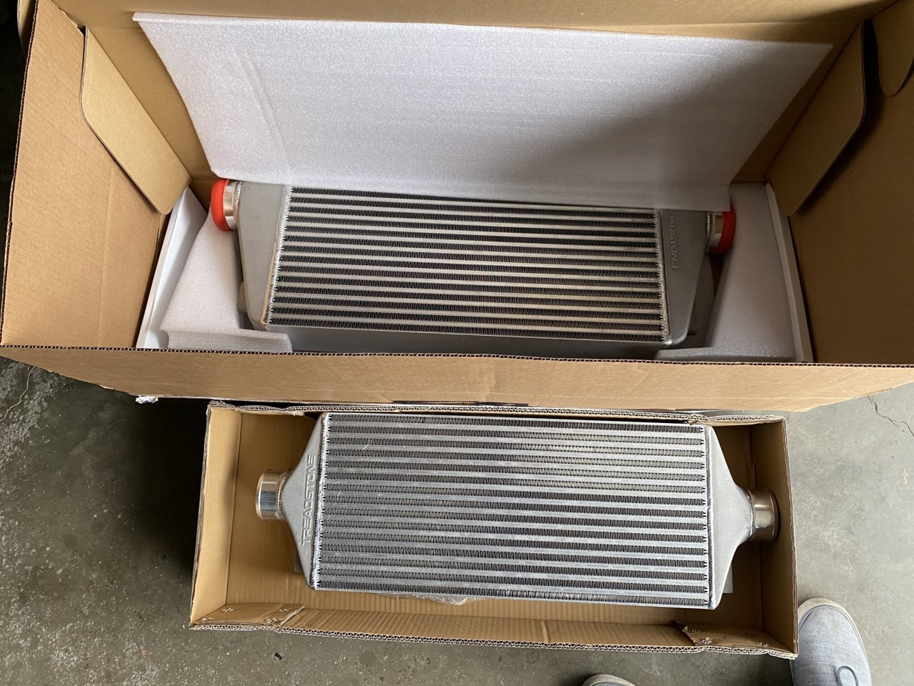

    I’m glad you got the TR10C to work. I accidentally ordered both intercoolers (tr10c and tr1032)..stupid me :facepalm:. First choice I was hoping to make work was obviously the tr10c as it would avoid cutting into the rad support. Silverlining to my boo boo was if the tr10c failed to work as intended then I would have the other.

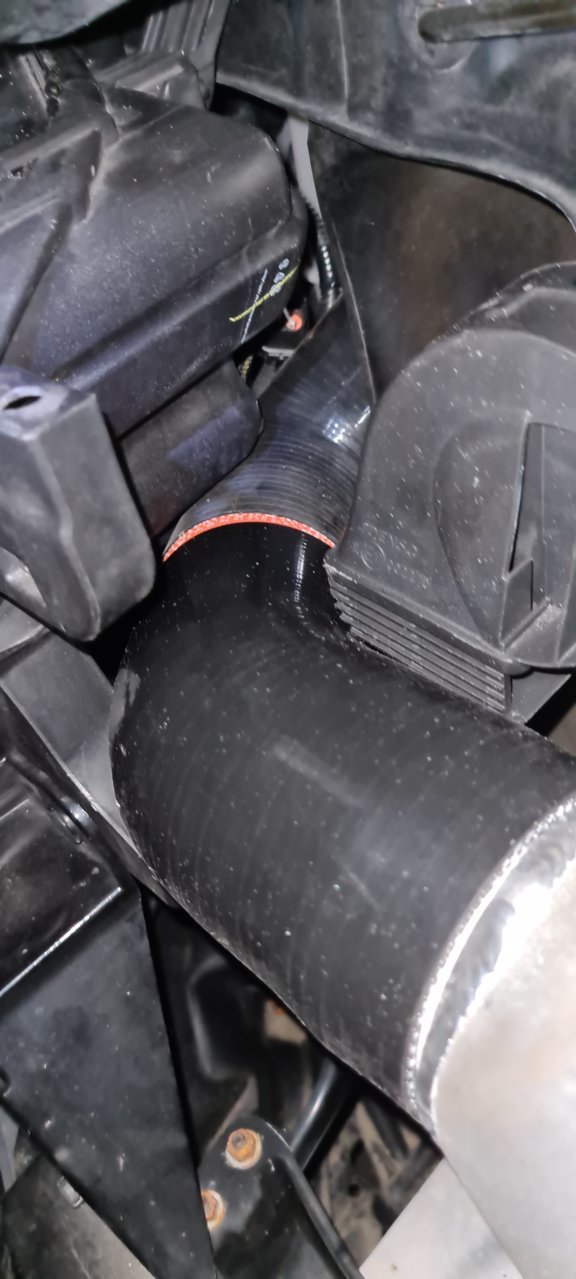

  14. Sep 20, 2020 at 10:01 PM
    #9354
    JamesT
    JamesT Well-Known Member
    May 26, 2020
    #329438
    261
    2018 TRD Pro, MT
    Go with the 10C for sure. Of course getting the mounting right will be the difference between shaving off some of your headlight plastic or not. The 90 degree couplers are just for mocking through the headlight hole. I will get a little more clearance with 3" hard pipe.

  15. Sep 20, 2020 at 10:15 PM
    #9355
    Speedwaytacotuesday
    Speedwaytacotuesday I love riding in my wife's Taco :p
    Dec 8, 2017
    #237994
    389
    Calgary, Alberta
    2016 TACO LTD, 88 4runner, 4th Gen 4Runner
    TRD S/C 2.3" pulley mild ported Portmatched/cleaned intake runner Ucon EMS/cam gears/160 t-stat 840cc injectors 255 LPH walbro fuel pump Urd equal length headers Urd competition y-pipe AFE 3” Exhaust Vibrant resonator Oil Catch can Ratio-tek valvebody upgrade 3" bilstein/OME lift Dakar rear 7-leaf pack 32" KO2's load range C Stealth custom wheels Ray-10's Volk Te37X’s Tundra front 13.3” brakes Custom fab rock sliders LC-2 wideband autometer boost gauge Cravenspeed gauge pod mount Scangauge 2 SC MODS: Pulley ripp mod/belt wrap mod/ fleetrunner belt/ tensioner stop delete mod/ bypass jet delete mod
    ^agreed. Appreciate the photos
  16. Sep 21, 2020 at 5:45 AM
    #9356
    rj_taco
    Feb 28, 2017
    #211935
    240
    Thanks, yeah it’s quiet! Very neighborhood friendly until you get on it. No rasp, no drone, very tame. Should sound even throatier with the twins + high flow cat. Res and muffler are flow through. So pretty much straight pipe. Haven’t hooked up the cutout yet, should make it a bit more rowdy!
  17. Sep 21, 2020 at 6:29 AM
    #9357
    FirsandFire
    FirsandFire Well-Known Member
    Dec 6, 2018
    #274991
    796
    New York
    No more Taco. A 2500HD and a Bronco sport
    The sound, the welding, the pie cuts. You sir knocked it out of the park.
    rj_taco[QUOTED] likes this.

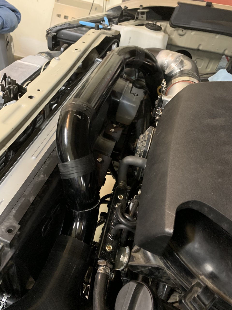

  18. Sep 21, 2020 at 8:17 AM
    #9358
    MESO
    Feb 16, 2015
    #148809
    16,292
    State of Jefferson

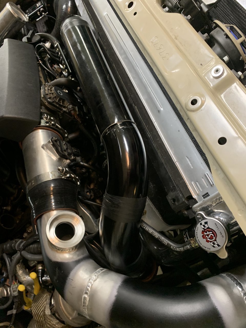

    Thanks. To do: powdercoat intercooler pipes, install the oil pan+ fuel pump controller, finish installing remote fuel filter, Fill it with fluids and cross my fingers.
    Little setback as I had to Redo the IC pipe from pass turbo side. I originally mocked it up with the OEM radiator, but after swapping to a larger aluminum there wasn’t room:facepalm:. So now it snakes under the charge pipe and crosses over. Trying to make as much as I can 1pc welded to eliminate using a ton of couplers.
  19. Sep 21, 2020 at 8:23 AM
    #9359
    Torspd
    Torspd Tor-nication
    Sep 18, 2009
    #22958
    26,470
    Tor
    The Great America!
    MMVI 4.4L 4x4 Access Cab
    "I mod my mods."
    ihatemytruck and whitedlite like this.
  20. Sep 21, 2020 at 8:23 AM
    #9360
    MESO
    Feb 16, 2015
    #148809
    16,292
    State of Jefferson
    MODCEPTION
