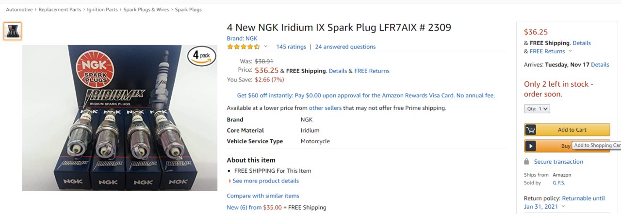

    Looks likes these plugs can be sourced locally. I just did a quick search and every napa near me has them in stock.

    looks like one kits worth on Amazon too

    Snagged a set off Amazon, assuming they’re good, what gap?

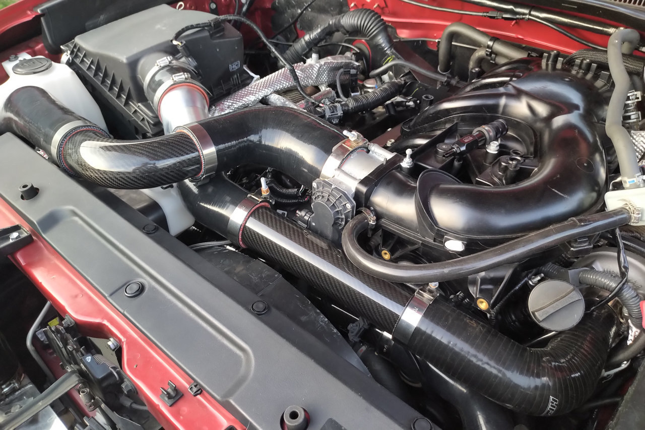

    Well at least Matt knows he can source plugs for kits at local automotive hardware stores, I’m still concerned about the piping I didn’t receive. I was aware of not getting the intercooler and piping in front of radiator, but everything behind it should be included. No one can tell me this pipe changes because I run a different intercooler.

    The ones on Amazon, ebay, and other online stores that I have purchased from are fakes. Read the reviews, they are all chinese fakes.
    any piping from the end of the "Y" on the drivers side and up to the 90* on the passenger coming out of the top of the radiator will not work unless you use the same style intercooler setup we use.
    The non intercool version kits did not come with this piping because I've seen the intercoolers you guys have been posting, it won't work. That's why there is a 300 dollar difference in the two, it accounts for the intercooler and some piping.
    The intercooler we use doesn't cost 300 bucks by itself.
