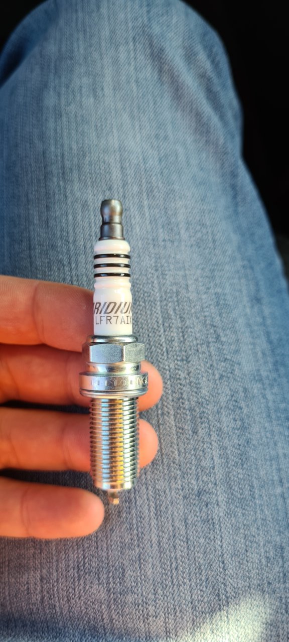

    Picked my set of the NGK’s down the road at the autoparts store, wasn’t a problem at all.
    For anybody with troubles finding them and maybe considering an alternative and by using the Denso IKh22, according to the Nasioc forums there is no difference interms of performance between them and the NGK’s. However, it was noted that the iridium pad of the Denso is smaller and tend to foul quicker and also makes it more fragile to knocking the tip off more easily. 1st choice would be the LFR7AIX but if nothing else the IKH22 are a good second choice.

    I can tell you my personal luck with the Denso's in a supercharged gen. 2 was poor. I tried 2 sets and neither lasted 12,000 miles with the fine wire center electrode eroding rapidly on all plugs not a specific cylinder.

    When I had my ms3, I initially had densos on my initial turbo upgrade, and they got fouled up really quickly. Went with NGK one steps when I went big turbo and built bottom end and they lasted way longer.

    Local Napa had them. Not a lot but snagged 6. Confirmed genuine.

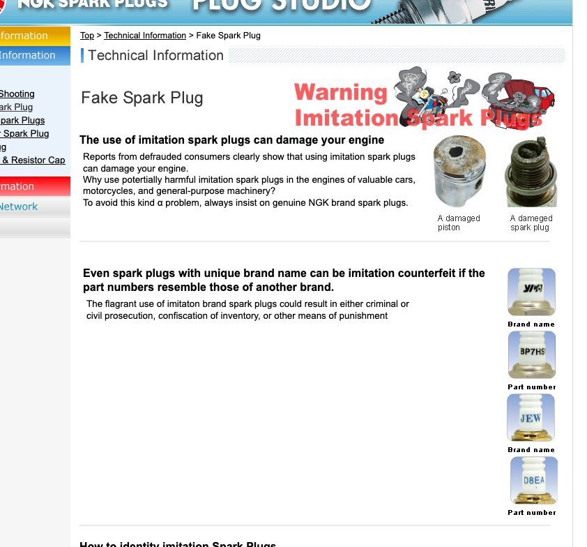

    How did you confirm?

    napa isn’t going to sell knockoffs

    Just know.. if you have a JEW spark plug, it's fake.:rofl:

    All of the above. Napa shouldnt sell knockoffs but i did a visual to make sure, because i have gotten ACdelco parts that were chinese knockoffs.

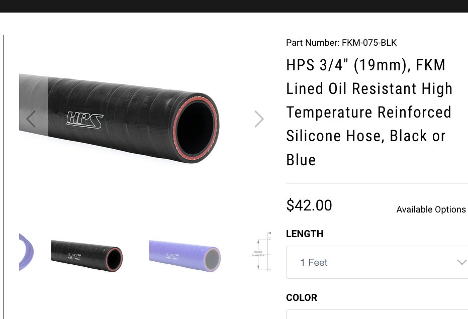

    Unfortunately it's still puffing white smoke. My next plan of attack is to pull the turbos and re route the oil return completely with newer hose. I have a feeling coming off the turbo the black HPS hose is getting kinked somehow. It's pretty soft and when it gets hot can make it even softer. IMO it's more for intake/vacuum/heater/etc. I should have ran HPS FMK lined high temperature from the start which is much more rigid and I'll have peace of mind because it's rated for oil/gas.
