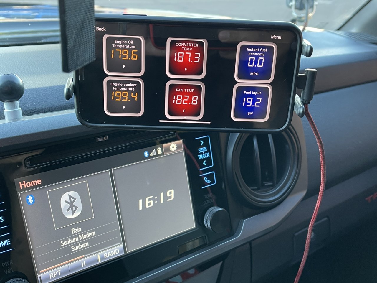

    Oil temp seems to stay just under coolant temp.
