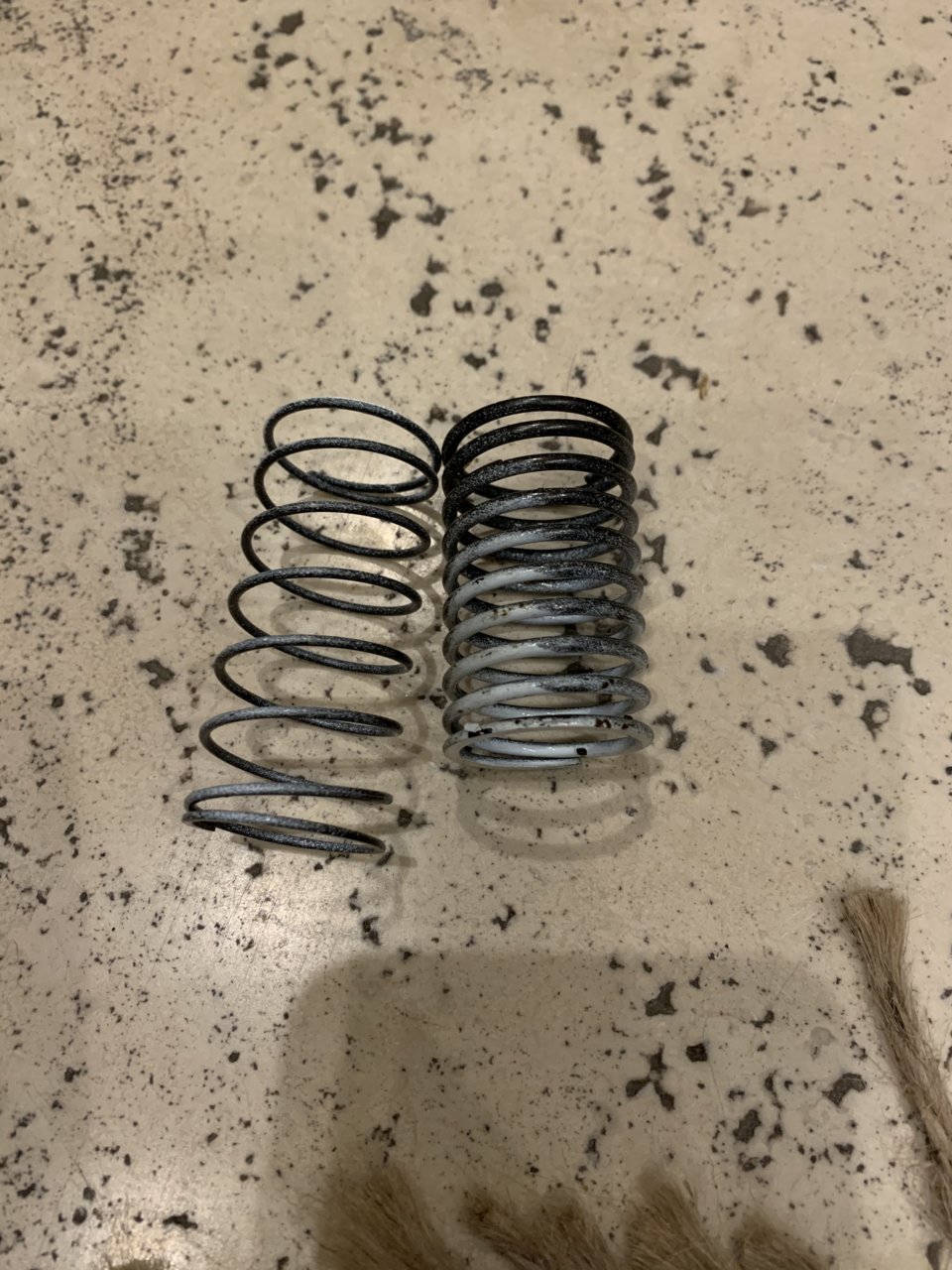

    That was me! I also had two different springs in my turbos, wouldn’t have noticed of i didn’t swap out to 7psi. Worth a peak!

    Wow thanks for the heads up I will make sure I check them before install. What springs did your turbos come with? I was under the impression they were all coming with 7 psi springs.

    Np, Not sure what they were. I’m powermax, they came with a set of 7psi springs as an option.

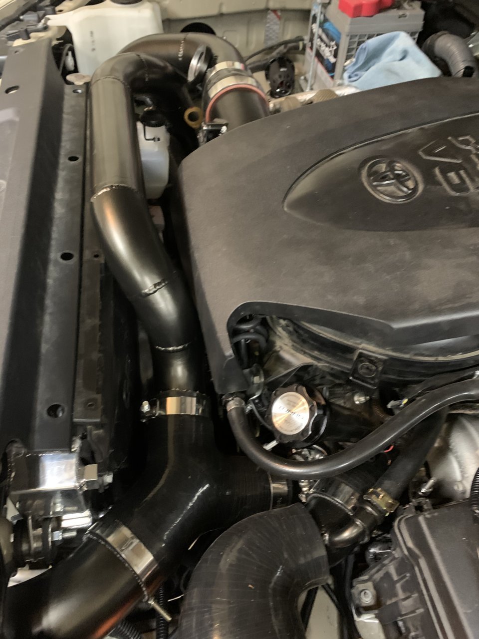

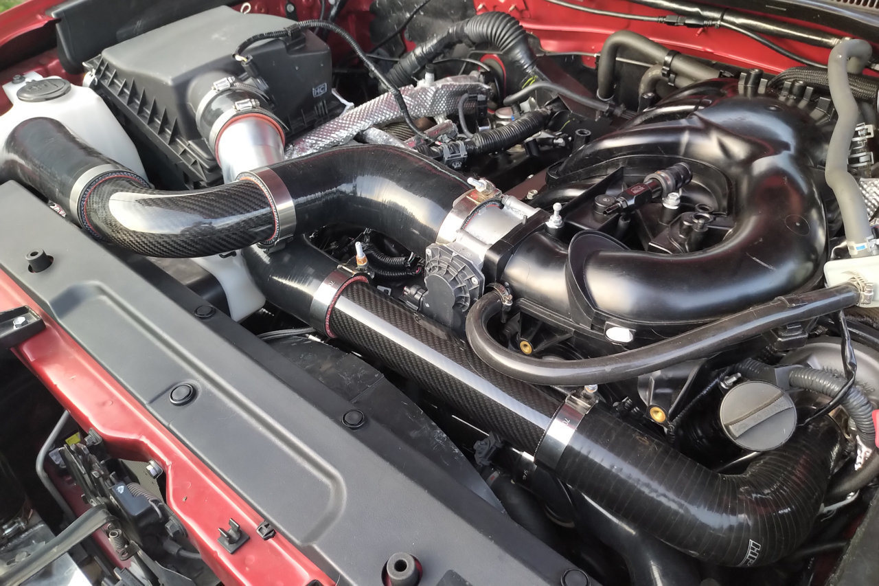

    I did a couple weeks ago. Dropped right in. Kept the clutch fan though. Meso switched to an E-fan. I might later but for now I don't care.
    What meso had to do was run his intercooler piping on top of the radiator. The csf radiator itself isnt much thicker than the factory radiator though. Keep in mind, Meso has dual intakes, so his piping is completely different than Mat's.
    Mat's cross radiator pipe is from factory filter box to driver turbo. Meso's is from passenger turbo to Y coupler. Similar, but different. Mat also has 2 pipes crossing, Meso has 1.
    Here is what Mat's setup looks like:
    Meso's:
    One thing you will notice is that the factory shroud doesn't fit the same. The holes no longer line up for the plastic clips. In Meso's picture the holes are empty.
