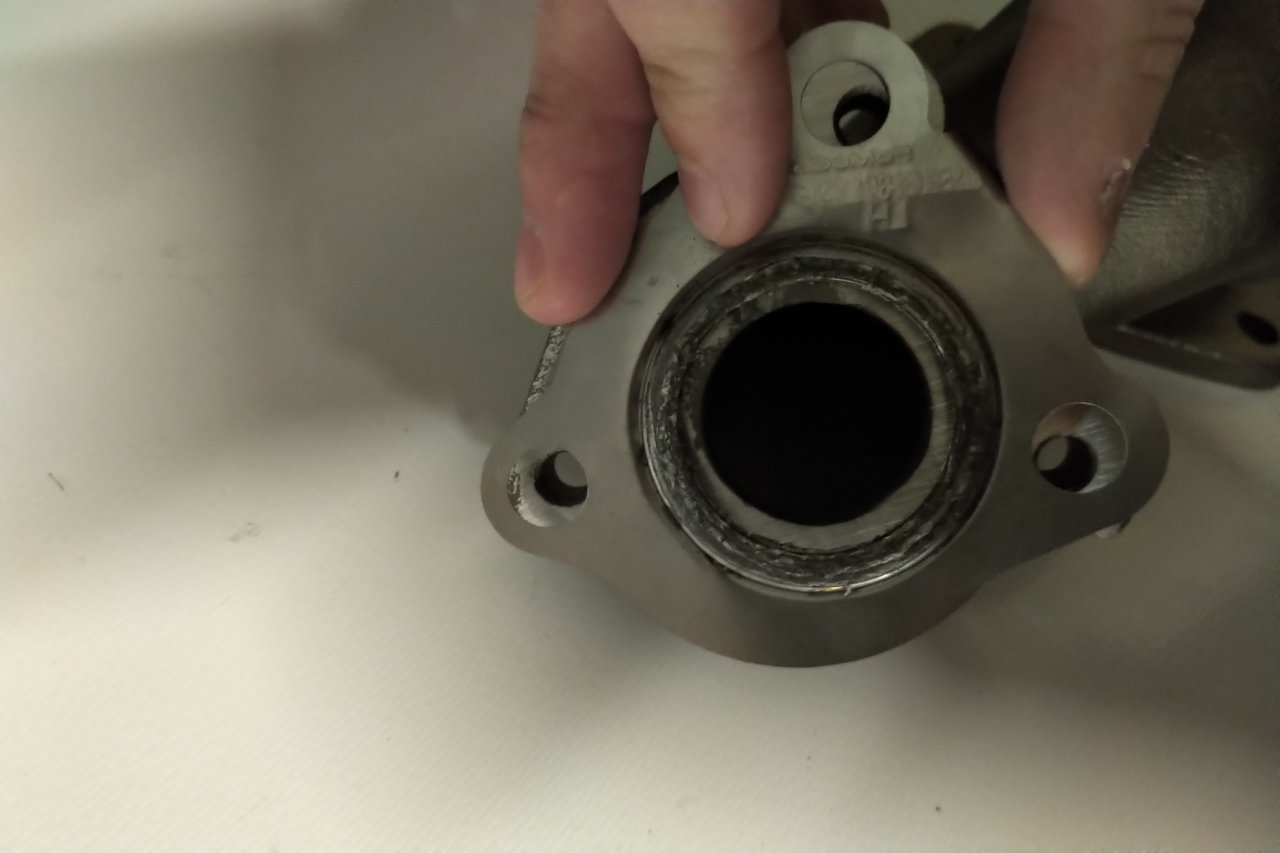

    They had separated the turbos and manifolds to double-check everything because of the other things they'd talked about, and so that's where that came up, because the ring left behind showing where they were seated together and showing where hole of the turbo likely would be crosses over the hole on the mani, which they said could possibly mean that it's not fully open. That's why they were wondering if they were swapped.

    If what they are seeing is on the *passenger* side that is OK as you/them can see the turbo side hole is a bit bigger than manifold side hole.

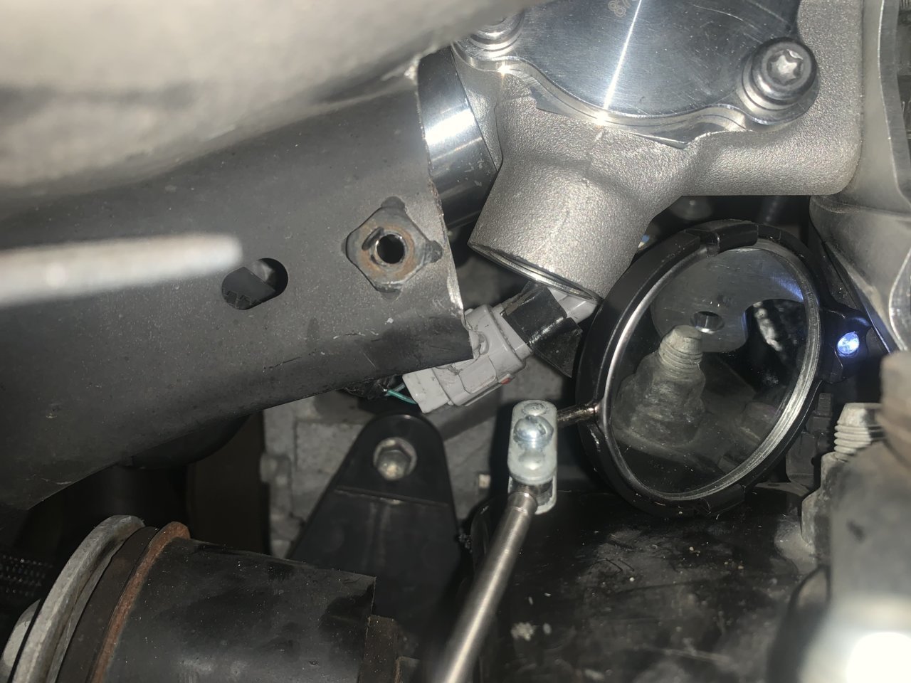

    I think you’re right. With the photo below, which I tried to hold as straight up and down as possible, would you agree that the vband needs loosened a touch and the turbo turned clockwise? I think that will get the wastegate clear of the tower.
    Mirror pic
    Wastegate goes on the far side of the mount in this pic. The bolt you see through the hole is the coilover stud.
    mZiggy likes this.
  13. Dec 5, 2020 at 7:13 AM
    OVTune
    OVTune [OP] Well-Known Member
    Mar 27, 2017
    #214557
    8,112
    OVTune
    should be more towards the engine.
    you can loosen the 8mm bolt / 10mm nut (on the hot side) and shift it
