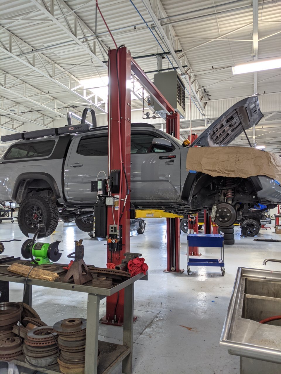

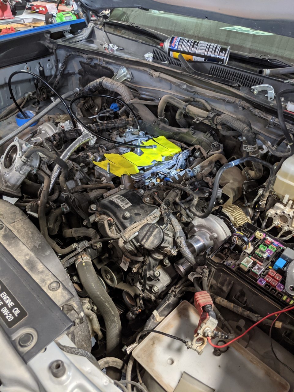

    Stopped by the shop today. Overall, things are going well. Turbos are in, same with the downpipes. They're aiming for me being able to drive it around Wednesday to Friday. The tech working on it is also an instructor and the whole shop has multiple vehicles in there, so he can't work on it non-stop from 0800-1700 is my assumption. :notsure:
    He said when everything's done he's going to give a detailed list of the stuff he had to cut/trim/modify and why, to help with future kits/installs.

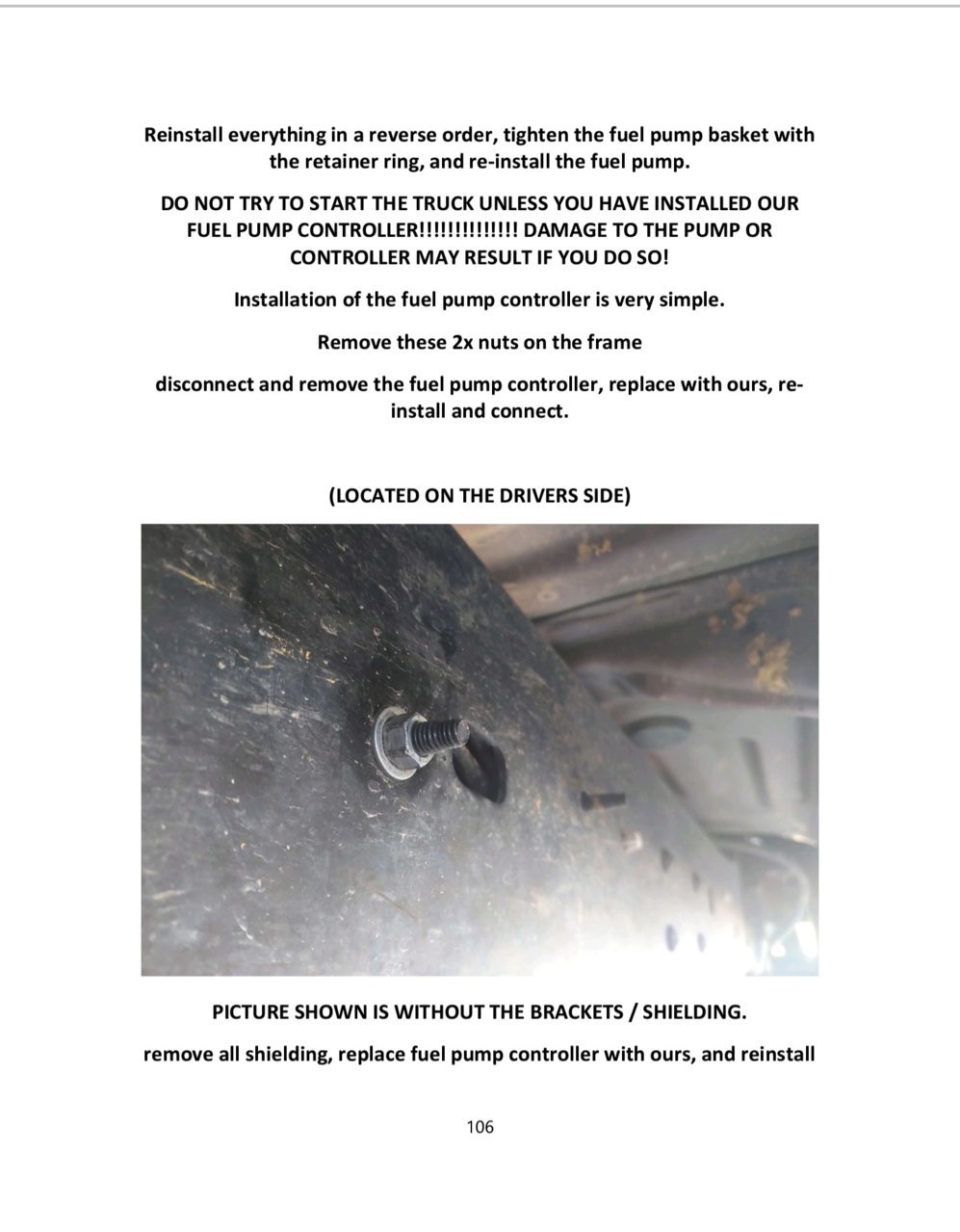

    Maybe I am mistaken here, but you can't use this pump for the recall if you dont have the turbo and fuel controller from the kit.
    Just a guess but this pump is not wired the same as the factory pump therefore it will not fuel properly. Our pump is a 4 wire input and this one is a 2 wire input. Mat knows the fueling system better than most so maybe he can explain better, but I'm thinking he is able to use this pump in this setup because his controller uses a larger range of dynamic voltage to control the pump using PWM through one positive wire, while the factory pump is using 3 different positive wires. Maybe a hi/med/low output?
    Bottom line see his installation instructions below.
    If your truck is not actively having a fueling problem dont worry about it. Toyota will replace yours for free anyway. Only a problem really if you are boosted and you suddenly go lean under full boost. N/A you'll probably just get some hesitation and maybe an eventual failure and a tow. Even then a recall doesnt mean every one will have a problem...just that some are, so they are replacing all in a series to be safe.
