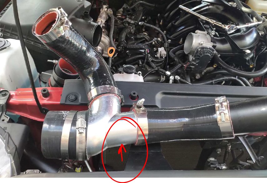

    What am I supposed to do with this?

    Isn’t that the pvc line?

    It's the passenger valve cover breather (part of the PCV system). It's supposed to plug into the intake pipe, but it looks like a fitting may not have been included with the kit in order to plumb it into the new piping. It's 5/8".
    I looked through all of OV's pictures and the install guide and I saw no mention of it, and in all the pictures it is missing. I didn't see any fittings or hook ups in the new pipe pictures either. I highly doubt it's part of the carbon pipes, so I assume there is supposed to be a fitting similar to the boost reference fittings that goes through a silicone adapter. It's important that it's plumbed back into the intake. Probably just forgot to include the fitting.
    Speedwaytacotuesday likes this.

    I’m open to suggestions on part ordering if someone already figured it out, otherwise I’ll start looking tonight.

    You could always get one of these fittings and weld it to the aluminum Y coming off the intake filter housing. This would put it between the MAF and the turbos, so an ideal place. It ensures all air is metered.
    The factory 5/8" hose might even still work if you flip it so it's pointing back at the housing.
    https://www.amazon.com/Aluminum-Weld-Barb-Weldable-AN617-10/dp/B06XS3G8PR/ref=sr_1_2_sspa?dchild=1&keywords=ICT+Billet+5%2F8"+Aluminum+Weld+Barb&qid=1608056866&s=automotive&sr=1-2-spons&psc=1&smid=A1TNMI4LHV0ZX&spLa=ZW5jcnlwdGVkUXVhbGlmaWVyPUFPN0tNUE5EUlMxVVgmZW5jcnlwdGVkSWQ9QTAzMjI1ODczSkVVRkdLODlJQjVQJmVuY3J5cHRlZEFkSWQ9QTA0MjcyMzMzRTE0MU83MUE2SzVSJndpZGdldE5hbWU9c3BfYXRmJmFjdGlvbj1jbGlja1JlZGlyZWN0JmRvTm90TG9nQ2xpY2s9dHJ1ZQ==

  17. Dec 15, 2020 at 1:49 PM
    Turd Hawg
    Turd Hawg Well-Known Member
    Jan 7, 2018
    #240541
    844
    2018 DC SB OR AT (Sold)
    good shit JamesT, thank you. I’m going to order it this evening unless I hear the original OV plan.
