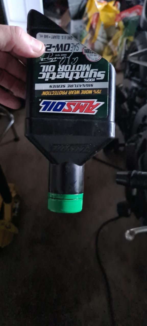

    FYI, if you do this and you are worried about oil fill....as long as the threads are the same as the factory cap (I assume so), 1qt Amsoil oil bottles are threaded the exact same. You can make a cheap funnel that threads into the fill hole.

    Someone has to check if the bottle funnel method clears the turbos. If not a long funnel or fill neck will do
