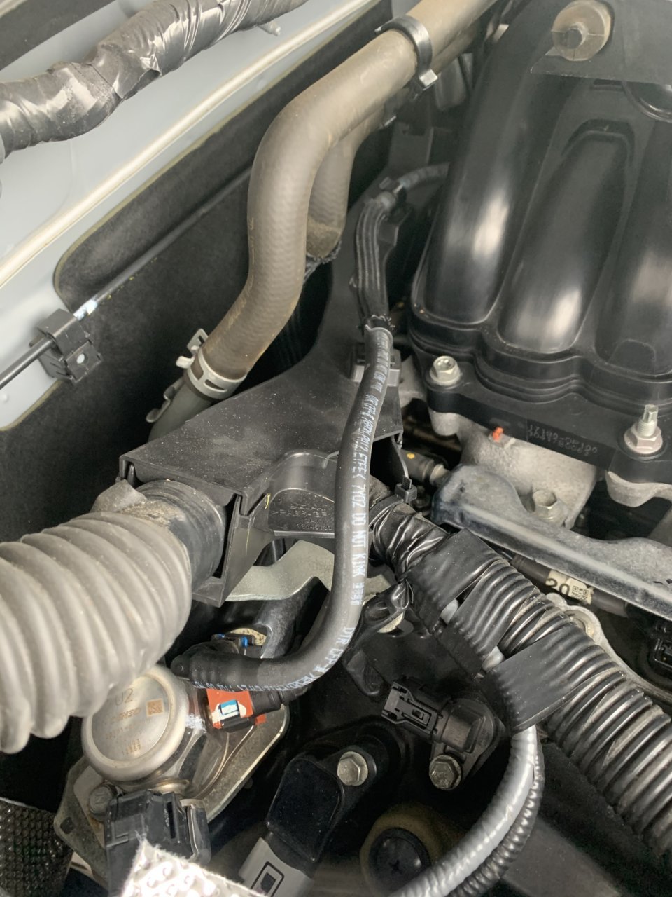

    Is the small diameter hose in this picture where I should be tapping a boost gauge in?

    That's a fuel line.

    no way that is fuel line.
    on page 8 of turbo install instructions it shows the hose. I emailed you

    Yah thanks, I thought you said there was a small line coming off the back of the intake that a 1/8” tee would fit on, that’s the smallest line I could see and didn’t pay attention to/from it was coming from.

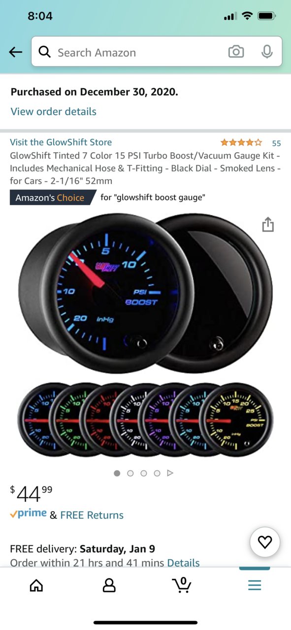

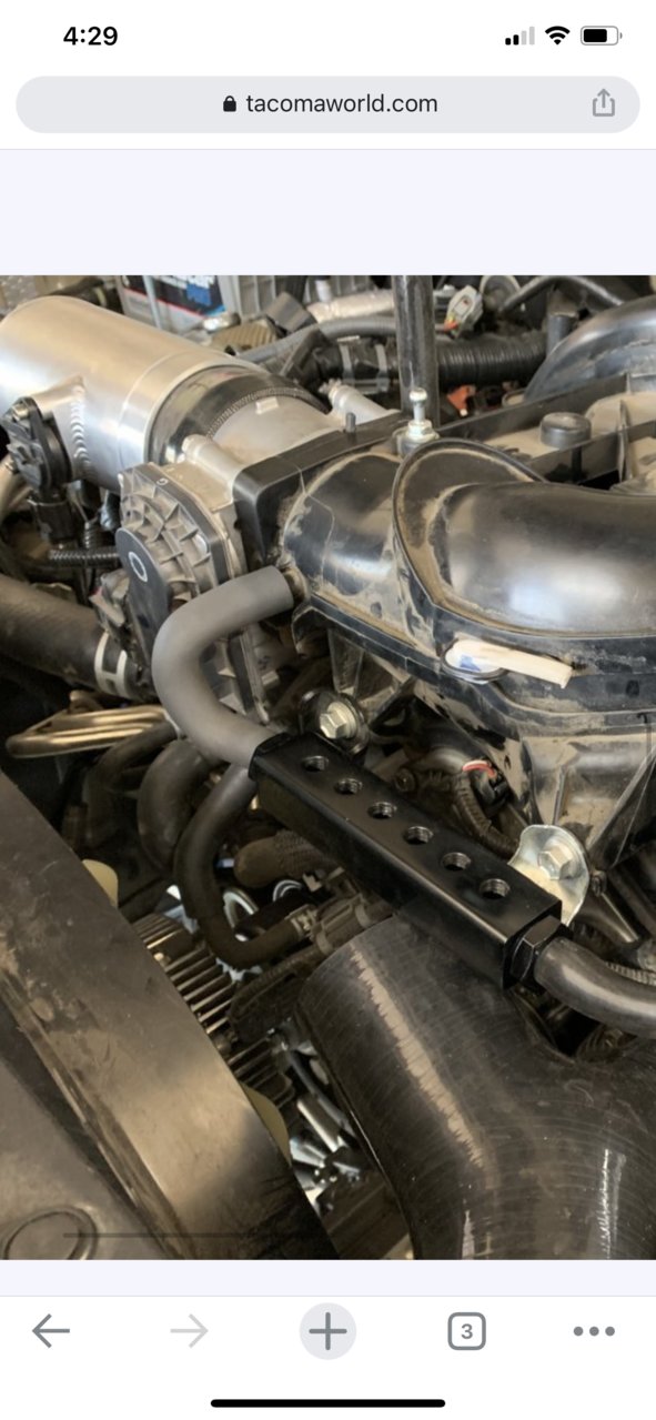

    I went with this one, ran it by OV prior to buying. I’m going to tap it in where Meso had his vacuum block on his truck, pic attached, but use a 3/8” 3/8” 1/8” tee. I’m just going to sit the gauge up somewhere to help with the tuning process, then remove.
