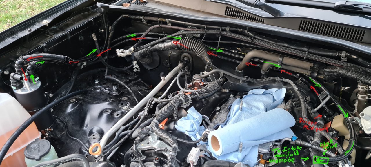

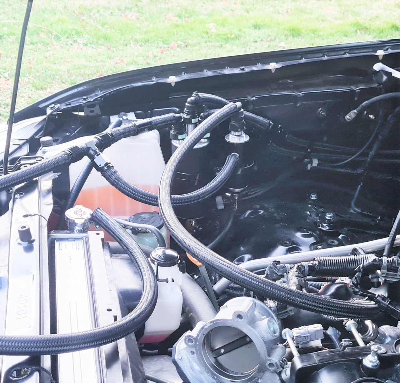

    Hate to change the subject, but I finally got the last piece of my PCV system and wanted to share. After a lot of thought and concern about oil getting into the turbo vanes from the breather I added a second can just to be safe. Keep in mind that I've got mine set up for dual intakes so I won't have the factory intake box in the way, so I just made a bracket to mount the two cans over there beside where one of my filters will sit.
    Up front, keep in mind not all my lines are cut to size since I don't have the turbos or intake piping set up for final termination.
    Below you can see with the intake manifold off so you can see the line routing. Red is going/coming from the PCV Breather on the driver Valve cover. Green is going to the bottom of the intake manifold. This line doesn't have it at the moment, but will have a one way check valve to keep air from coming out of the intake manifold under boost (boost leak)
    This next picture has the blue line (the vacant one above) coming from the can and going to the intake pipe. This one will connect between the filter and the turbo. This line also has a one way check valve just after the can to prevent any air from going back into the can from the intake (this has to be before the Tee). Now on the second can, there are two ports. The Yellow line is coming from the passenger valve cover breather. This is a two way line so no check valve needed. The purple line goes into a Tee on the blue line so that it also gets connected to the intake pipe (also a two way line). This allows the intake to pull suction on the valve cover as needed, or inversely allow the crankcase to pull air in under boost (if needed). Side note, check valves should always be flowing away -> from the can.
    Both of my cans have quick drain fittings on the bottom with a Tee'd drain line that goes under the truck, so when I need to drain both cans, I just put a pan under the one line and turn both valves, which are easily accessible with the hood open.
    Something to keep in mind when setting anything like this up, secure all lines everywhere. Something as simple as a random aluminum bracket, or anything could over time rub a hole in something critical. My firewall hoses practically touch my brake lines so I secured them all with clips and mounting tabs to keep everything from rubbing. And yes, those zip ties holding my battery cables to the main harness are temporary.

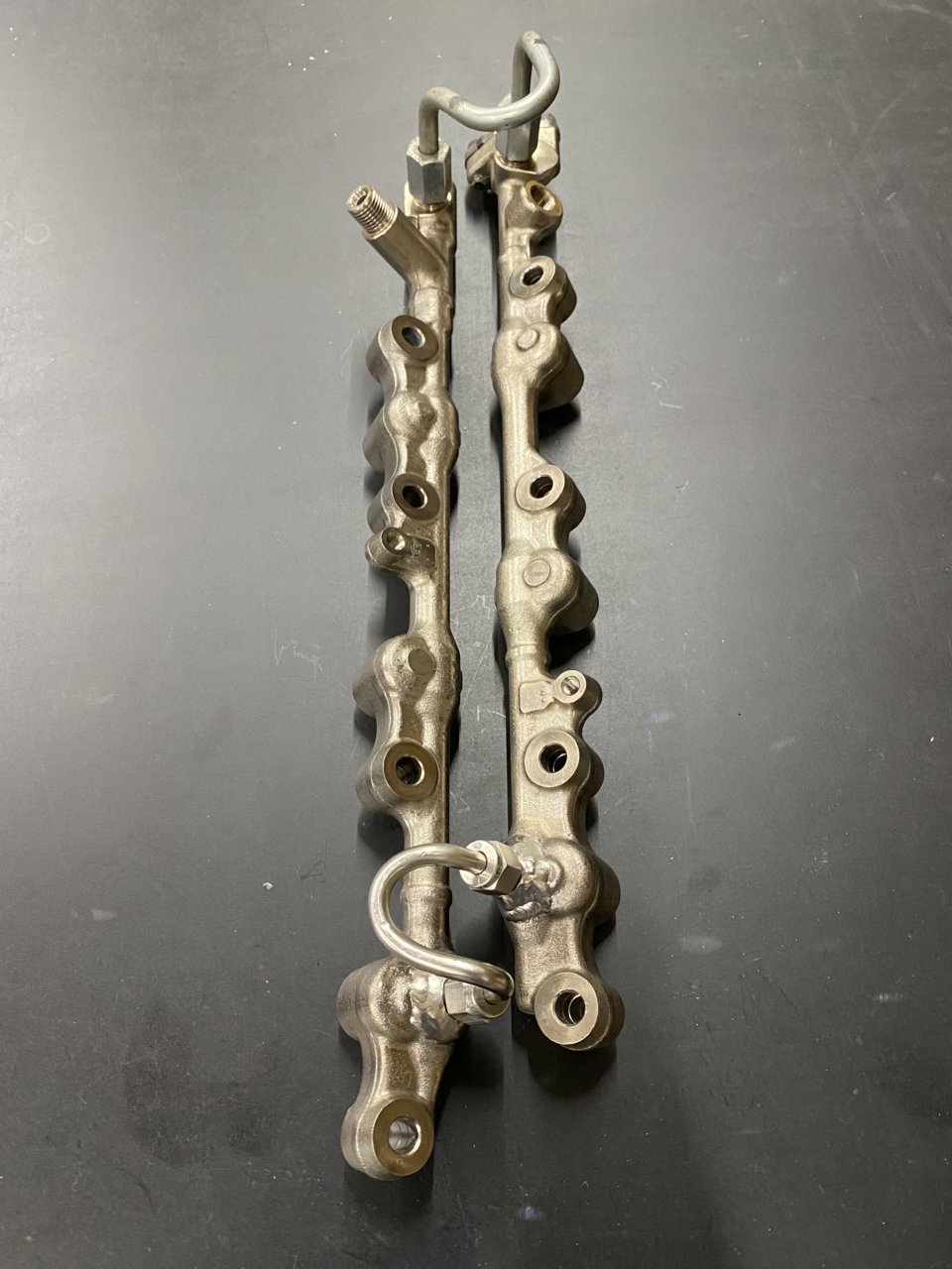

    @OVTune
    Do you think this will keep bank 1 from leaning out @ 10+ psi? The bend is a bit crude using .065 wall, .035 should do better (.180” ID). Working pressure is 5k+ psi, so no issues. I ended up welding the fittings in just for good measure.
    SC4333, skyking3, Skydvrr and 6 others like this.
  15. Jan 8, 2021 at 10:49 AM
    OVTune
    OVTune [OP] Well-Known Member
    Mar 27, 2017
    #214557
    8,112
    OVTune
    assuming the welds won't break because it's cast (that was my only fear welding mine), that should work really well to stabilize fuel pressure.
    maximum PSI the system sees is around 3500-3600psi during decel.
    have you installed them in your truck yet?

    That's an elegant solution, I like it. Nicely done

    I used 308L filler rod, worked really well to blend everything in with the base metal (correct filler for this application). Fitting is 316 SS. The rail seems to be CF8.

    it should work perfectly.

    Not yet. I bought a spare rail to try it on first. Trying to come up with a way to pressure test it.
