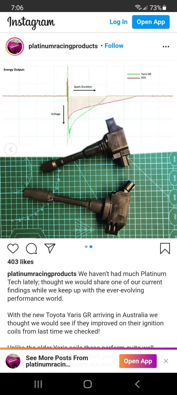

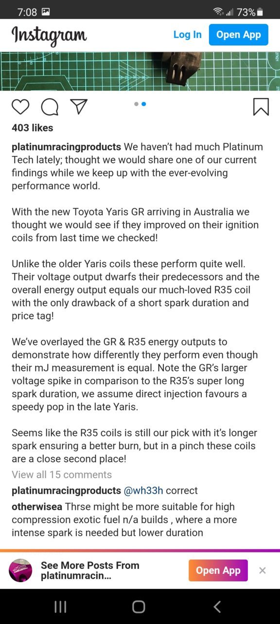

    Check this out. For however useful or not it may be.

    Nice info. I went with R35 coils
