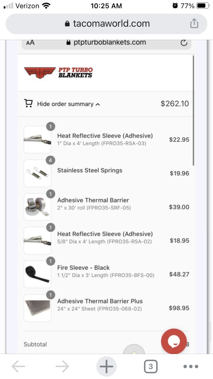

    I just PM’d Meso this same question, but can anyone give me a run down of how they utilized their heat shielding? Picked up Meso’s used blankets and picking up lava wrap for the DP’s.
    But, I have no idea what I’m doing with anything on this list:

    Are u doing the install too?

    Yessir, me and a buddy and a lift
