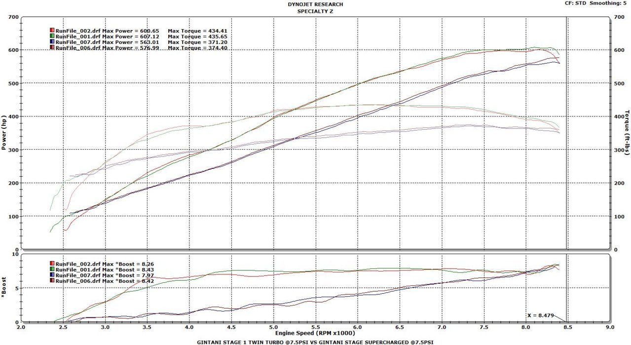

    You must of had a bad experience with a poorly engineered turbo kit. Why is a centrifugal so superior to a turbo besides ease of install? I’ve elected to use a centrifugal over a turbo before but that was on a V8 in a lighter vehicle where I wasn’t concerned about adding low rpm torque. Plus, the centrifugal allowed me to keep AC whereas the turbo would not. In the Tacoma I wouldn’t bother spending $5k unless I was seeing significant low rpm improvements.

    Yeah that's the key, guy obviously knows Toyota code but maybe needs to get back to what makes sense.
    Trucks never going to be a race car and low end torque from a small supercharger would be perfect. Charger will fall on its face after awhile but who's building 500whp tacomas. Not many
    To many issues with turbos far as I'm concerned. Heat, space, ground clearance, and forget about carb cert. Had twins on 350 and vette. 600 whp in 350 guess if you want to be the guy with twins on your tacoma go for it I'll stick to making sense.

    Ok, let’s say that a Procharger makes 7 psi and a (properly sized) turbo makes 7 psi. You can see 7psi from 2500-6000 rpm with a turbo, it doesn’t require a lot of exhaust flow to drive the turbine. With the centrifugal supercharger, they build boost in a linear way as they need engine rpm to drive a belt. At 2500 rpm with a centrifugal supercharger you’re probably not going to have more than 1-2psi. Peak boost is never achieved with a centrifugal until peak rpm.
    I don’t think your belt driven 2 psi is going to have more power than an exhaust driven 7 psi. Especially considering that turbos are known to be more efficient at creating that boost to begin with.
    Here’s a dyno of a BMW comparing a centrifugal blower and a turbo on the same motor:
    A centrifugal would be a simple install though :rolleyes:
