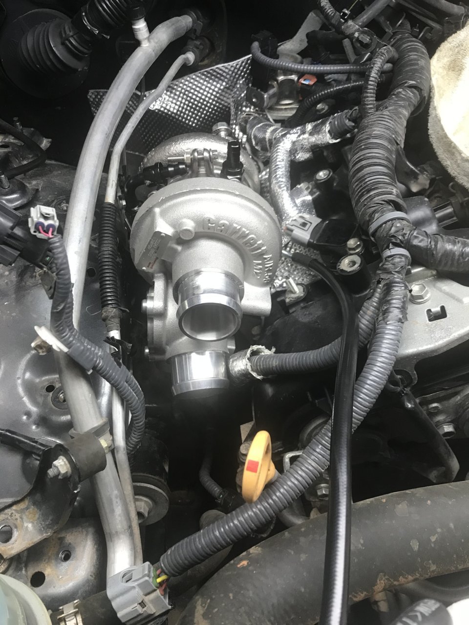

    @OVTune question, I regularly tow a 2700# trailer (SXS) and a 3600# trailer (camper). Is there any issue towing on 7 pounds of boost with the big boys? Should I snag 4psi springs from you and run a boost controller? I take both these over a steep mountain pass several times a year as well.
  17. Jan 17, 2021 at 11:05 AM
    OVTune
    OVTune [OP] Well-Known Member
    Mar 27, 2017
    #214557
    8,112
    OVTune
    Shouldn't have any issues except bad mpg.
    However, if you expect that you'll be towing up mountains AND expect you'll be towing in boost for long periods of time (let's say 2-3 mins of non stop in boost acceleration) you should consider an upgraded in tank pump.
    The stock pump has a 2 fold problem.
    1. Initial bursts of huge fuel demand, and long duration of high fuel demand.
    So when the stock pump needs a huge burst (say to support high boost) it can't hold pressure.
    But at the same time when you need high pressure with constant high volume over time it also starts to fail to maintain pressure.
    Short runs, and lower demand it can handle.
    This isn't so much a problem of the pump itself as it is a problem of the 3 stage energization of the controller.
    I know on the stock truck, going through the Colorado mountains when I was testing a few years ago, the truck would scream at the top of 3rd just to maintain speed. You'll likely be towing in 4th or 5th. The tune is modified so that in this range where you'll be producing a lot more torque at low rpm it runs with a bit more fuel, to keep the temps down. So you'd actually do better to keep the RPM lower and boost up with towing.
    However, under no circumstances should it be gearlocked and just flat out floored it in 5th / 6th with towing.
    If you do a LOT of towing, and it's a lot of weight, definitely let us know se we can make some additional Towing modifications to your tune for the ECT button.
    Finally, with this recall expanding to 2017s and older on these fuel pumps, we may require fuel pump with any kit in the future. It's just not worth risking.
