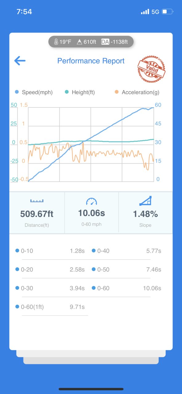

    This is my 0-60 before any tuning. Might be able to improve just learning how to mess with this. Had to let off before a 1/4 due to traffic otherwise I’d post that up. Interested to see what I get with tune and then with turbos. Trying to record stats pre turbo for comparisons.
