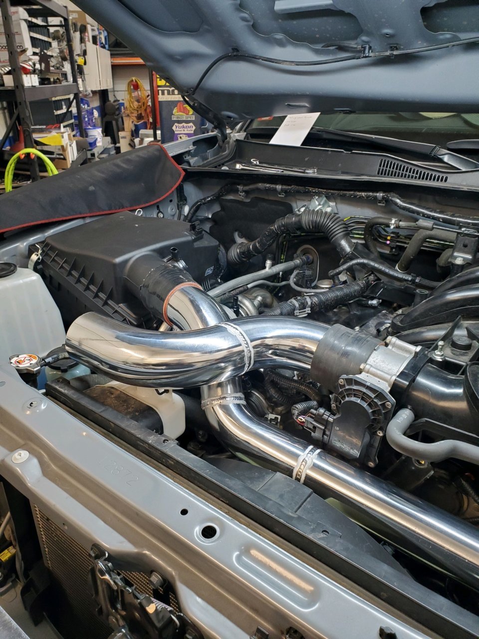

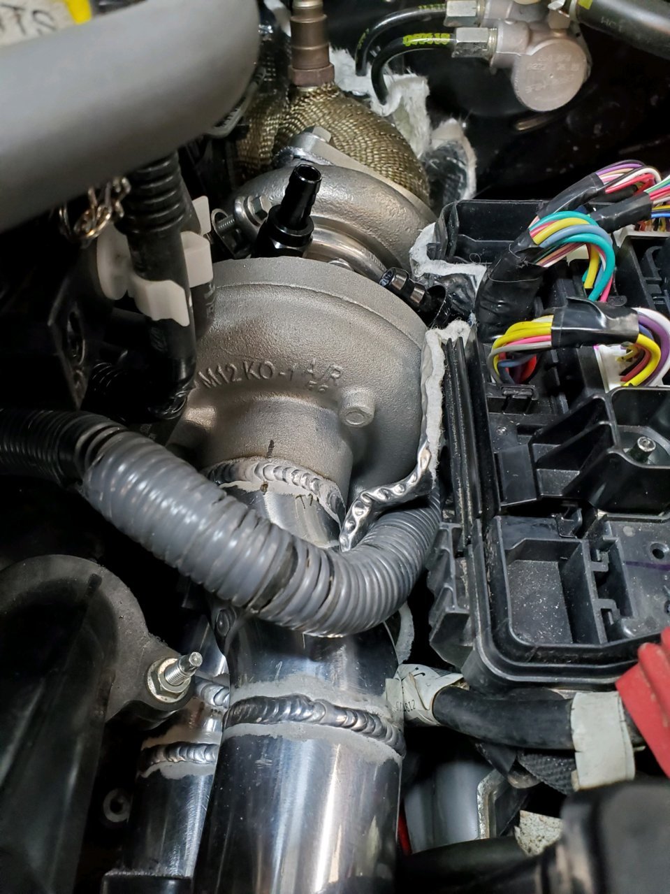

    Nice fab work! Hope welding the inlet directly onto the compressor housing won’t be an issue if any warranty issues arises. You def won’t have boost leak that’s for sure :rofl:
