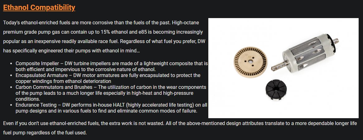

    Anybody know if the upgraded fuel pump is brushless? pump controller has voltage. Dropping the fuel tank to take out the pump and hot wire it to see if it fires

    It looks like a brushed design:

    Thanks. Dropping the tank to get the pump out to test it. Never heard it firing when cranking. Hopefully its the pump or controller

  14. Jan 29, 2021 at 12:34 PM
