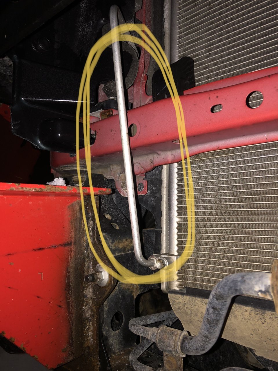

    This isn’t turbo related and I don’t have a kit, but I’ve been following this since the beginning and know you guys have been dickin around under the hood a lot. My question is, can this line be bent?

    yes, ive had to bend this but higher up where it goes to the engine because of my bumper I installed. They have some flex

    haha exactly why I need to bend it thanks!

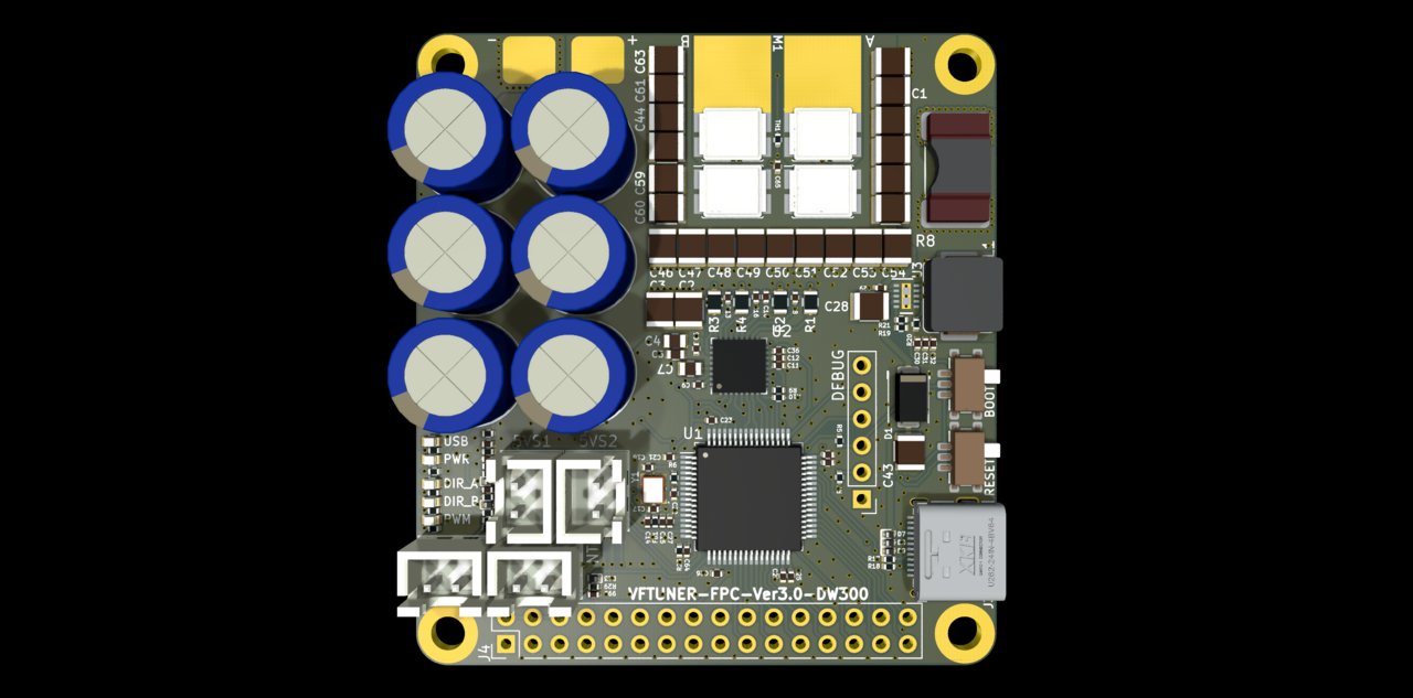

    an update
    First I want to say that I hate delaying things just as much as you guys hate delays. I absolutely hate when things don't go as planned and when I have to delay things and explain why, it always feels like an excuse. We have had road blocks everywhere.
    an update for everyone who is currently waiting on their kits to ship / arrive.
    About a week back I mentioned that there was a delay on shipping. Each person still waiting on kits all have 1 thing in common it's our upgraded fuel pump setup.
    Well originally our fuel pump setup used a Cytron based brushed motor control board / module capable of maintaining 15+ continuous amps and other useful features.
    We ordered these in bulk to get working on the pumps.
    Our first batch of the boards were problem free, worked great and are still working fine.
    However on the second order, it was like Russian Roulette. Some worked some didn't, some were programmed backwards (high when should be low, low when should be high).
    I do not know why, but like anything else going on in this crazy time, I'm assuming it's COVID related and the semiconductor shortage right now that caused this problem with quality control or someone using cheaper components.
    There is no way I could have foreseen this, but I immediately put a plan into action right away. (some of you guys who have our pump controllers right now already know).
    Rather than order more and *hope* their quality control is back to where it should be, cut the idea out of using *any 3rd party components.*
    Unfortunately, this caused a set back in time to get them done.
    The good news is the boards are better, they use a faster microcontroller, they have better expansion capability.
    the new FPC is completely designed from scratch, no cytron or other "off the shelf" based on components.
    168mhz STM based MCU
    30 AMP and 18 volt capable, etc.
    Our new version 3 fuel pump setup is *already done*, *already in production* and *already on their way*
    it will *not delay things* much longer.
    For people who have fuel pump controllers, as we emailed you you'll get a new one, just swap it out and done.
    I want to apologize, we had no choice but to take this route now or risk issues popping up later.
    Literally every step of the way through this kit process when we relied on components from another company they have failed.
    There will be no more delays after we get these boards.
