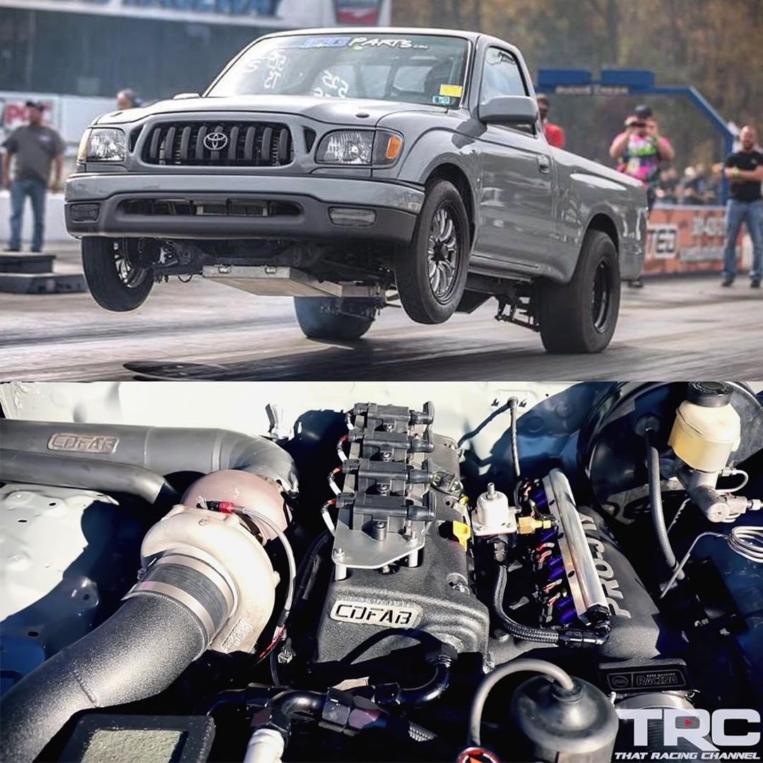

    Stepped away from this thread for awhile, because I'm getting too impatient.
    Just saw this bit and it's not helping. Looks like a rear diamond axle is back on the menu for me whenever this kit finally makes it's way to me.
    Just one question: at 25psi will we finally be able to wheelie a Tacoma?
