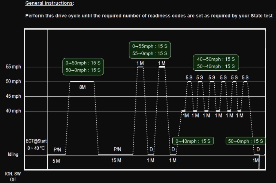

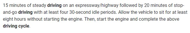

    mZiggy
    mZiggy Honey badger
    Apr 8, 2017
    #215707
    4,709
