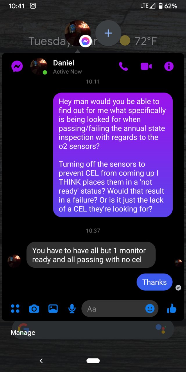

  20. Mar 30, 2021 at 9:42 AM
    mZiggy
    mZiggy Honey badger
    Apr 8, 2017
    #215707
    4,709
    Marc
    2020 MGM Tundra SR5; 2020 4R TRD Pro; 2008 4R SR5 v8
    Asked my buddy who works at the dealer. This is in El Paso, TX
