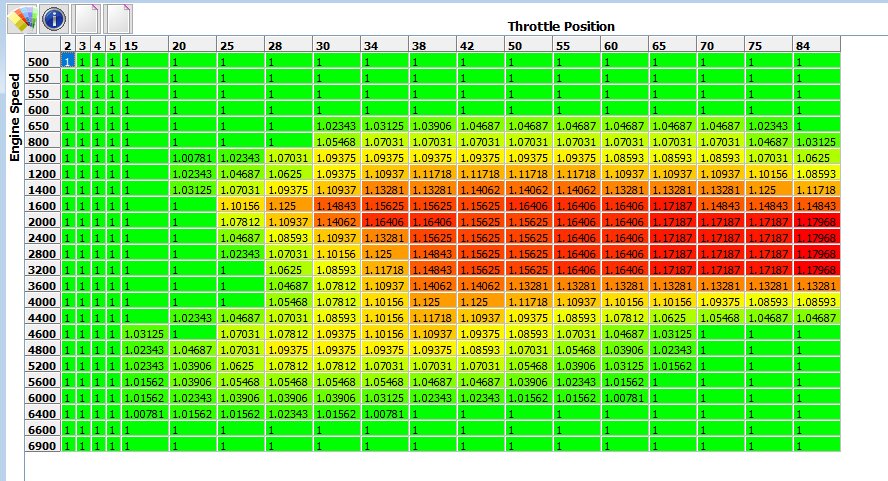

    TT Calibration Update:
    I will be emailing out some tune updates for everyone.
    This updated tune covers a lot of things:
    - improved drivability and improved response out of boost
    - significantly improved in boost - mid range RPM fueling
    - Fixes / reduces surge feeling during high to moderate throttle (in boost) under 4000 rpm
    - Fixes misfires/stumbling occurring during full throttle downshift (AT)
    - Fixes misfires/stumbling occuring during full throttle upshift (AT)
    - Eliminates throttle limits during WOT
    - Improves shifting (AT)
    - Improves full throttle shift timing (less delay)
    - Improves high throttle upshift
    - Improves in boost - moderate throttle 5th/6th gear TC Unlock
    - Improves cold start
    - Improves cold driving (however we recommend still staying out of boost during cold driving, at this time)
    We have patched a few tables for MAF control, so that adequate fueling is available during transition periods on/off throttle / moderate throttle where the ECU registers it's "1.0" VE but reality VE is higher.
    This table is normally available in vF Tuner but is not always used, however with this new version it will be used - full time.

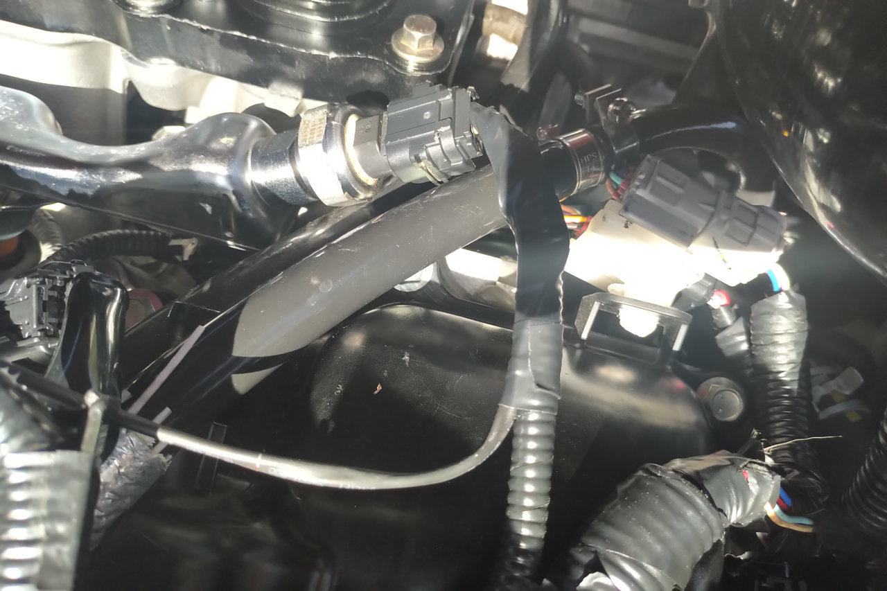

    Fuel pump controller:
    The new fuel pump controller (as previously mentioned) will require tapping into 2 wires on the OEM Fuel Pressure sensor
