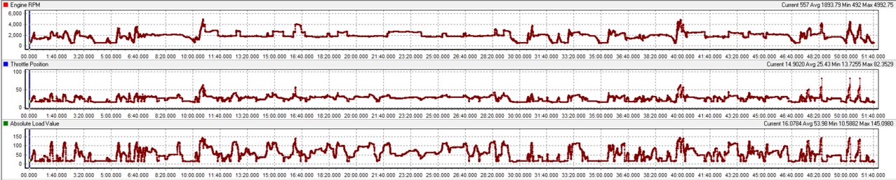

    I took a few but others are just of the tach..boring.
    video is still processing......will edit this post with log data and the video
    2017 TRD
    Powermax tubo kit ~ 7psi
    93 octane
    tow setup, loaded trailer and some stuff in the bed.
    Log snip attached during the drive.
    You can see with the exception of getting on the onramp 2x, the truck drives almost always right around 2000-2100 rpm. Speeds ranging from 55 to 70mph.
    I floored it a few times at the end just to see how weighed down it felt at WOT.
    other than that it didn't really ever need more than 30-40% throttle. and driving with 3-4psi in 5th lets it cruise along with traffic.
    But the point of this test was to confirm all is well (AFR, throttle, ignition, etc) really bogged down towing on this new map. So we can finally be done.

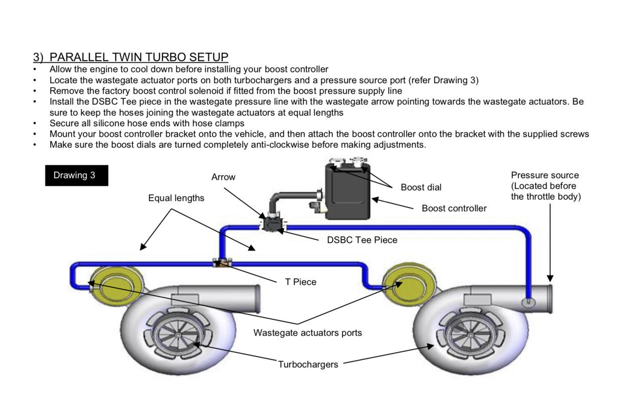

    So when I put a manual, single stage boost controller in, I actually need two of them no?
    Looking at what Turbosmart has to offer, it looks like they sit inline, meaning each could only support one spooly boi?

    Skydvrr and mZiggy[QUOTED] like this.

    Shellshock[QUOTED] likes this.
