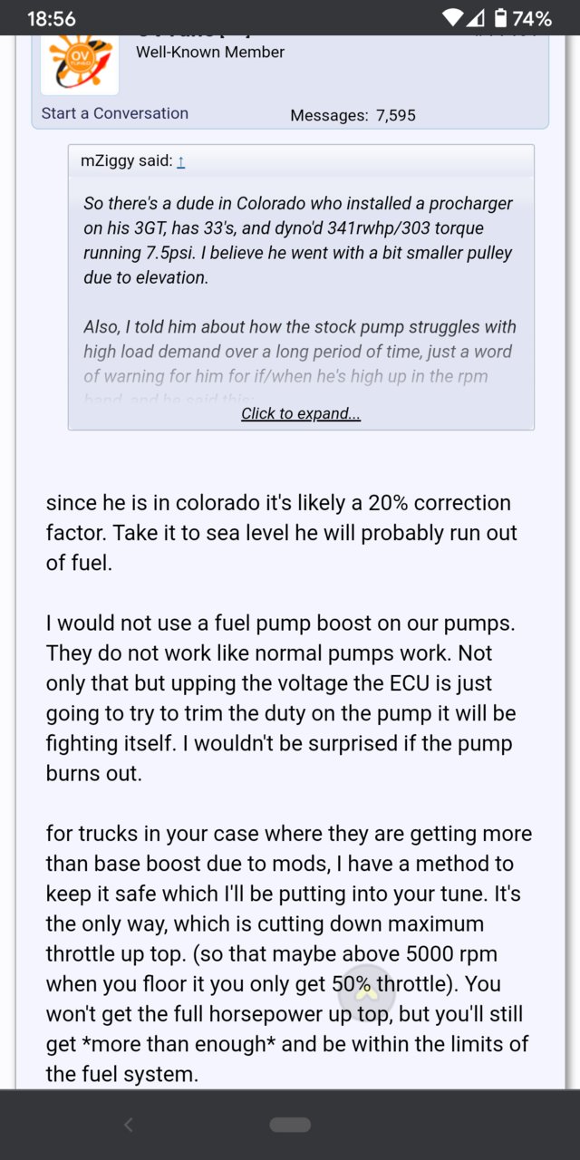

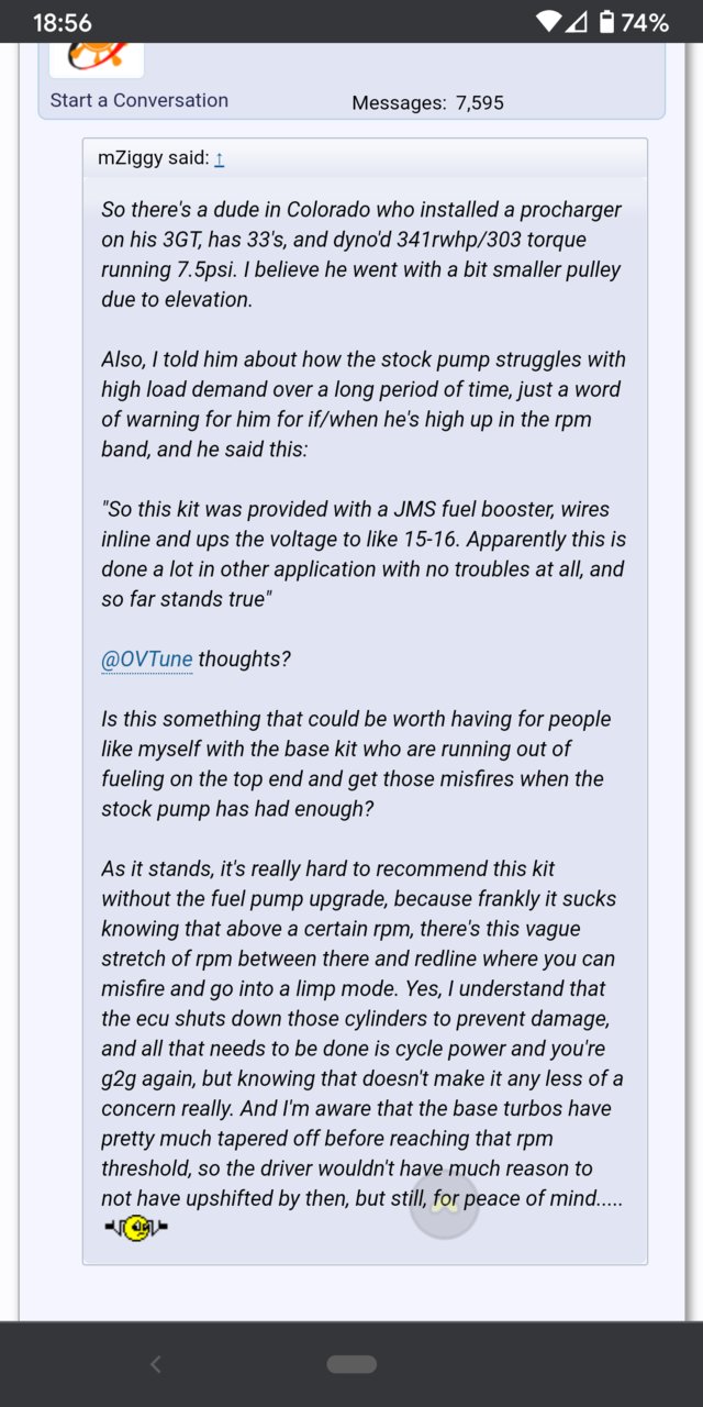

    Also the procharger apparently uses a voltage booster for the fuel pump that is probably not the best option for FI on the 3GT
    ownubad likes this.

    want to include this was just an opinion based on how the pump works.
    I have sent out some tune updates, to verify with those people all are good.
    There will be an engine protection mode built into the tune that limits your ability to throttle (and even rev) depending on engine temp.
