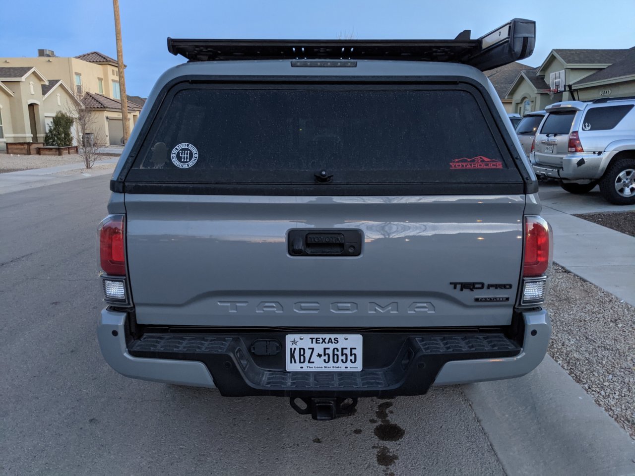

    Lol thanks man. My obsessive eye for things off-level and shit came in handy lol Here's a better shot of it.
    I really do love how subtle this emblem is. More my style than the Ecoboost emblems that I was considering.
