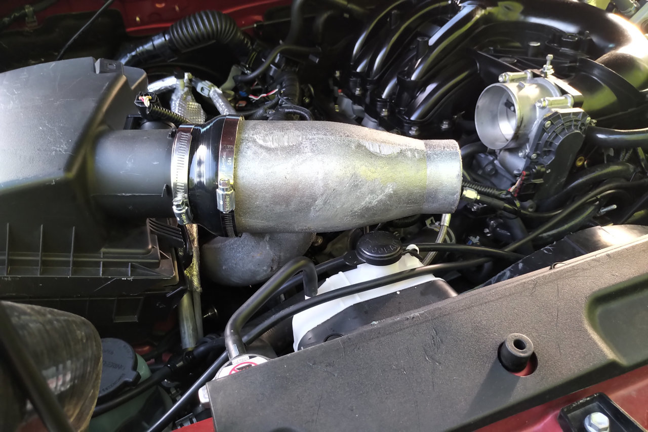

    Here is how the intake pieces will go.
    They are still the prototype pieces so yes they are uglier.
    These are expected ** to have the first batch actually done in about 15 days.

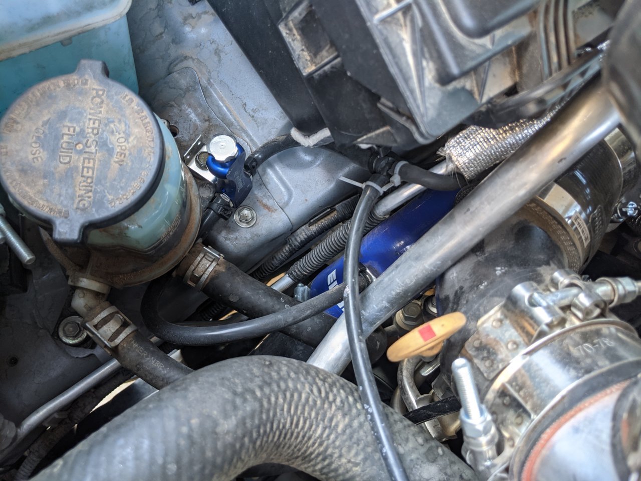

    I'm still hearing the same fuckin buzz at start up, when revving, etc. And I'm starting to think I was mistaking the sound being entirely an exhaust leak (which I had with the failed gasket), and thinking it's also the ticking from my high pressure fuel pump. Without a doubt louder than a few weeks ago...
    What does this mean?
    I've tightened up damn near every connection on the intercooler couplers. Even found my driver side turbo hotside connection to be a little off. Not realistically enough to matter I'd think but nonetheless I attacked it and a bunch of other connections and it seemed to help a bit, but not much overall. Still have the whine under high rpm, full throttle/boost.
    At idle and while revving, initial throttle bump to rev match, etc, I still have the sound that I've been clearly thinking was an exhaust leak (again, partially was one with the gasket) and all that's really left in that area on the passenger side is the HPFP...
    Loud buzz/ticking, way louder than ever before. And this exact sound is what started this whole charade in the first place.
    Just checked and I'm still not coming up listed for any recalls.

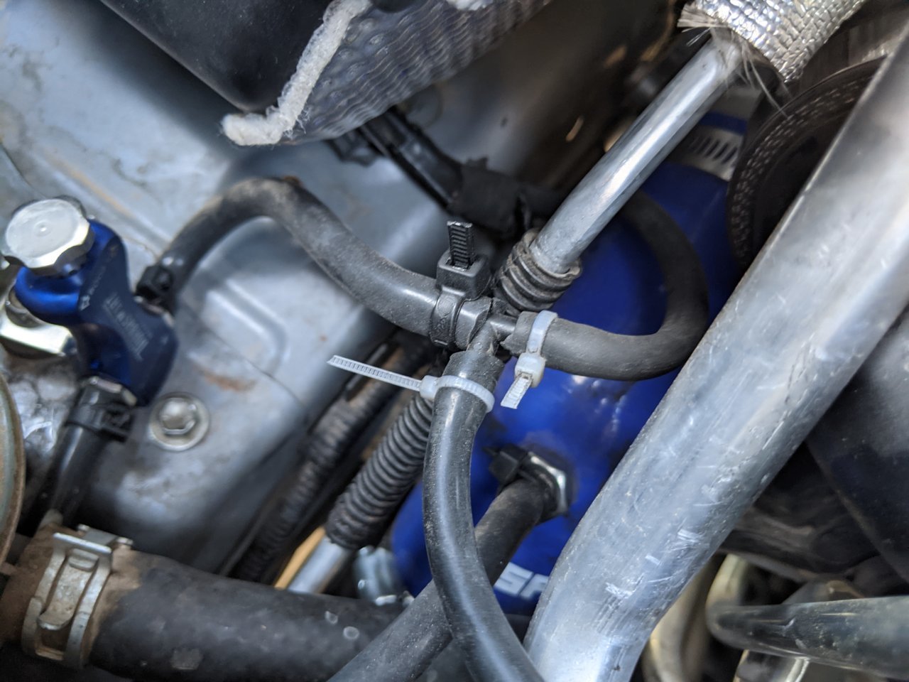

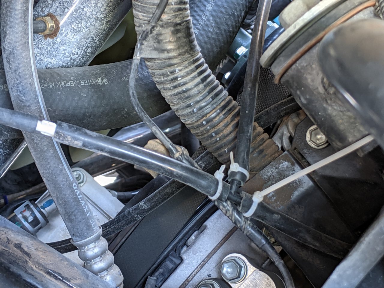

    Then idk. I still have a few silicone couplers left to check but I think I've exhausted that route. Who knows.
    Connections on the boost controller look fine. They're T'd into the existing boost tap lines which is correct setup iirc, without referencing the diagram again.
