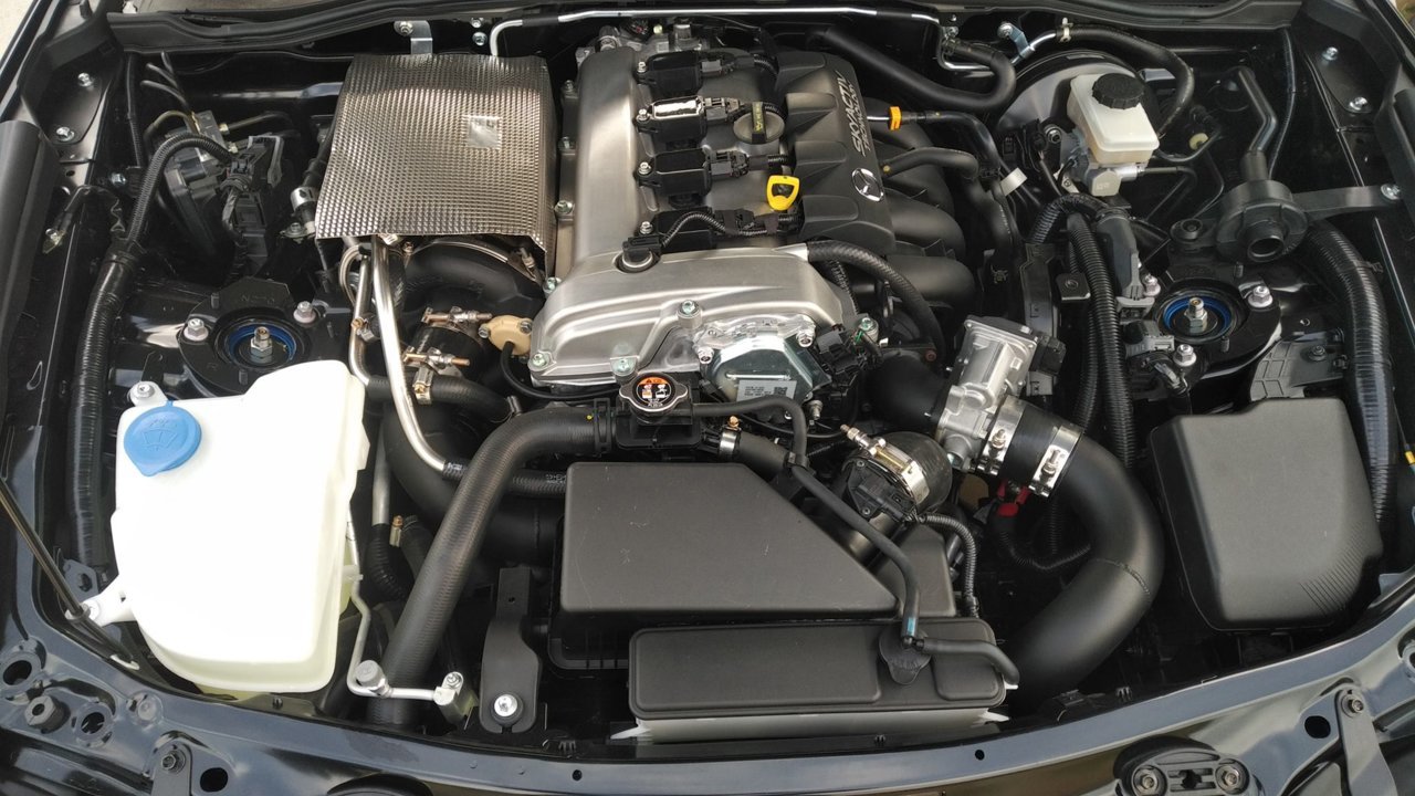

    This engine that I have tuned (and am tuning for more power) has 13:1 compression and runs 10psi on pump gas and 17psi on pump + methanol.
    with tuning.
    These newer engines with high compression, variable valve timing, etc have plenty of room to work. Compression is just a number.
    For example the skyactiv mazda 2.0L has 13:1 compression... a K20A has less, and the K20A makes 50+ more horsepower.
    Because compression is only 1 factor of many in cylinder pressure
