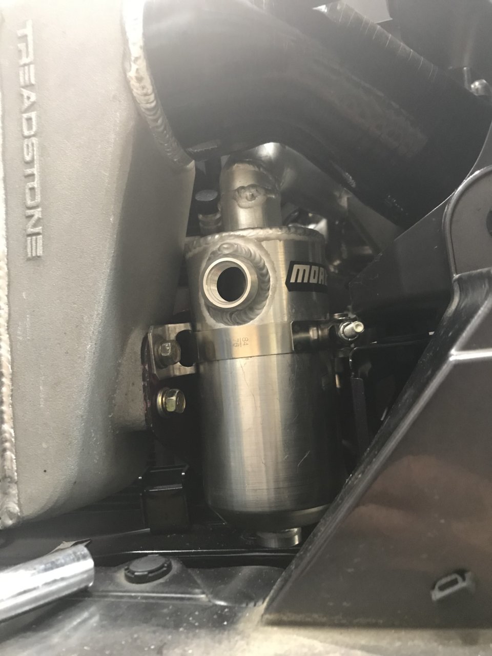

    What is the smaller hose that tee's off near the air cleaner?

    It comes from my oil catch can. I bought a morso that came with an air breather to vent to atmosphere but decided to route it back to my intake instead. Worried about evap codes.

    I don’t think you would want the crankcase air going past the maf even though it is going through a catch can. I could be wrong though.
